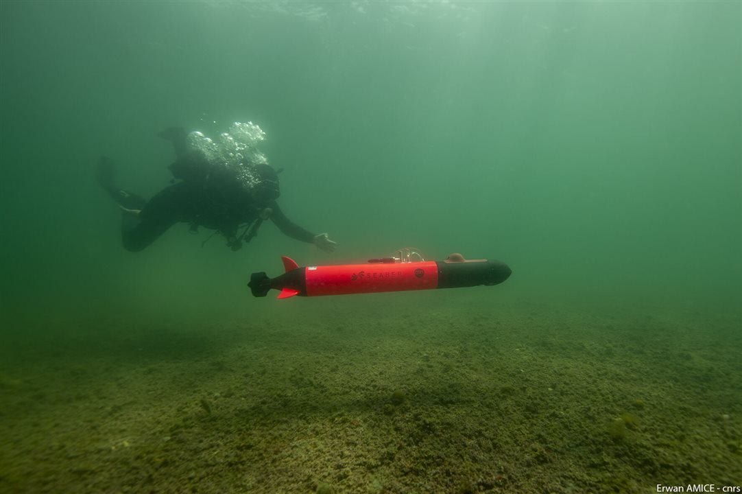

Seaber’s YUCO-PHYSCICO underwater drone. (Image Credit: Seaber)

The YUCO-PHYSICO autonomous system, developed by SEABER, measures 4 feet long, 5 inches wide, and weighs 20.9 pounds. It can reach a depth of 300 meters, and while running at its slowest speed, travels 25 miles on a full charge. The Doppler velocity logger ensures it stays at a set distance above the seabed. Researchers also program the depth and bottom-clearance limits so the drone will automatically ascend to the surface.
This underwater drone traveled along 1.9-mile-long lines, which ran from the shoreline near Elmenhorts to an anchorage that cargo ships use. It reached the seafloor before returning to the surface and repeated that cycle. This produced a path resembling a wave through the water as the AUV measured temperature, salinity, and oxygen at varying depths.
