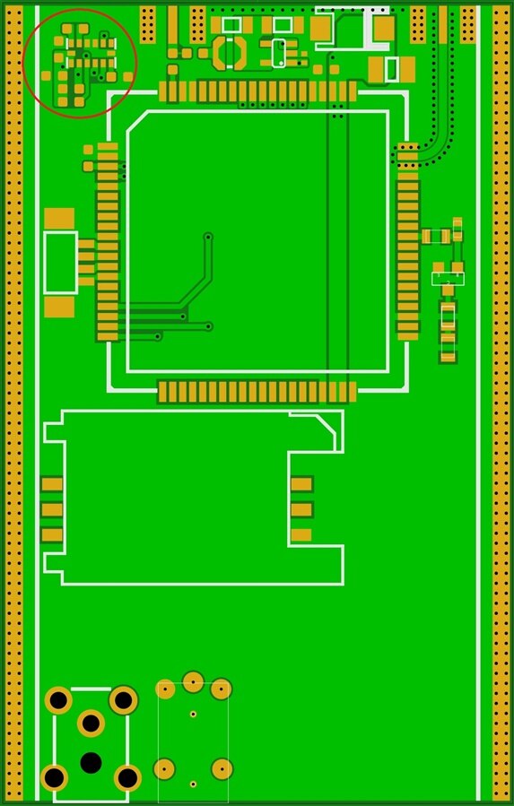

I am planing to use LSM303DLHC in my project. It will be inside aluminum box. for acceleration, it will not be a problem, but how about for magnetometer ?
Will alumina shield earth magnetic field that i am trying to measure ? I can deal with 10% errors

    Yes, i do understand about properties para/dia/ferfo magnetic materials, only problem is that i can found many threads about sensors nonfunctional inside aluminum boxes, and because at the moment i can't make pcb only to test sensor ( i only have one shot to make pcb image ) i need to know will it work or not.

    Can't you design the board for an internal mounting and then use some coax to move that sensor off the board and outside the enclosure if necessary. My experience is that construction before testing my designs usually costs me more time than it saves. If you are working with a project to measure the Earth's magnetic field you will likely want the sensor away from your board anyway because of the magnetic fields generated by the currents in its circuitry.

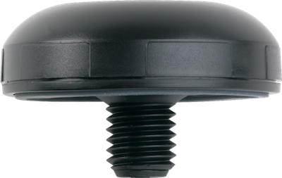

    If you experience any interference from the Aluminium enclosure you could interface the Magnetometer via an external connection. The device could then be housed in a better environment within a plastic enclosure. This external enclosure could even be mounted onto the exterior of the Aluminium enclosure.
    Perhaps something like this:

    Also, 99.99% of the time system will be using main lead acid battery, and only if someone stole my car, and park inside garage or whatever he do, my system should work. (MEMS device in red circle)
