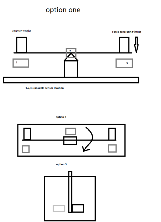

    hi,
    in the attached sketch , you can see what i am trying to do. Load cells with such high sensitivity and resolution upto 0.1mg are very expensive. and often unsuitable unless an even expensive rig is prepared for them. plus, there are many constrains that will effect the results.
    in this sketch, 1,2,3, and grey boxes are showing possible location for sensor placement.
    For measurement of thrust, What i am planning to do is to first measure displacement in the rig by placing known weights as simulated force. i.e. 1g, 0.5g etc. and plot a graph of displacement in mm or micro meter vs. force applied. and with this calibration graph, I will be able to measure thrust in mN range. Right now, I have not selected build material for rig, because what i have read in these forums is that, build material should be according to type of sensor.

    There is still nothing like enough detail in your description:
    How far can the sensing point move when the force is applied
    What is applying the force
    What resolution, accuracy, repeatability and hysteresis are acceptable
    How fast must the sensor respond.
    Open loop inductive will be awful for most of these, forget the LDC1000EVM  - it just isn't the way forward here.
    Ready made load cells are much cheaper than a lot of precision engineering unless you count machine shop time as free.
    Look at LOAD CELLS > Platform Load Cell 1004 this is a suitable (possibly) part - there are many others on offer.
    If you are determined on  a DIY sensor then at least consider force balance (Google it)  (may not work for you but you don't explain enough to tell).
    If long term stability is not important then making your own load cell is not too hard.
    MK
    less than 1mm.  resolution of 1~10micron will be required.
    a MEMS based micro thruster, (micro rocket)
    +-100 micro newton will be ideal. in terms of weight, 0.1mg will be okay.
    repeatability within +-3~5% will be okay.
    anything above 100Hz(100 samples per second) will be good.
    but sadly in my case, budget is below 200USD, so i am trying to find alternate sensors which could do the job.

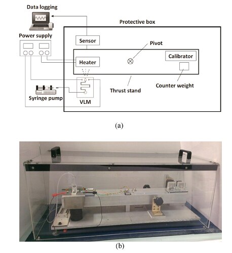

    here is the attached diagram of original rig, which i am reproduce.
    Original text "
    Thrust measurement
    A torsional thrust stand that resolves forces in the order of
    micronewton was constructed in our center. This dedicated
    thrust measurement facility was set up not only to evaluate
    the performance of VLM but also for other micropropulsion
    systems, e.g. a pulsed plasma thruster. A block diagram of
    the actual setup is illustrated in figure 5. A detailed working
    principle of a torsional thrust stand can be found elsewhere
    [26, 27]. In general, our thrust stand consists of an aluminum
    alloy beam of 60
    cm long supported by a flexural pivot
    (6012–400, Riverhawk) which provides the restoring force.
    Beam deflection due to the VLM operation was measured
    using a high precision optical linear displacement sensor
    (ILD 2300–2, MicroEpsilon) which has a resolution of 0.03μm at 20
    kHz measuring rate. An electrostatic calibrator
    was used to generate consistent and repeatable calibration
    force in order to establish the relationship between beam
    deflection and force. The entire setup was covered by a
    plexiglass protective box to reduce disturbances due to the
    external environment.
    Direct measurement of force from the VLM using the thrust
    stand is difficult. Mounting of the liquid feedline on the thrust
    stand surface has limited the thrust stand resolution [
    13].
    Alternatively, an indirect measurement technique was used.
    A heater pad was installed on the thrust stand and heated to a
    temperature of approximately 60
    °C. The VLM was externally
    mounted and aligned so that the vapor jets would impinge on
    the surface of the heater pad. The heated surface prevented the
    condensation of water vapor. The deflection of the thrust stand
    due to the vapor jet impingement was recorded. The same
    syringe pump and power supply were used for the operation
    of VLM.".

  • michaelkellett
    0 michaelkellett over 11 years ago in reply to e14 Contributor
    I think your best bet, taking into account the budget, is a capacitive sensor. Use flat plates with an area of at least 10cm^2 and you should get a reasonable capacity (9pF at 1mm separation). Make an oscillator where the frequency of oscillation is determined by C (single op-amp astable sounds right) and use  a micro to measure the frequency.  Design it to go at 100kHz at 1mm separation and it will rise to 200kHz at 2mm separation (f proportional to 1/distance).
    You can get 1 part in 1000 resolution and 100 readings per second.
    It won't be as easy as this sounds - you need the plates to stay // as they move and stray capacitance effects will cause problems. Put the oscillator right next to the fixed plate so you don't have long wires.
    I've designed quite a few transducers in my time but I don't know how much experience you have had - but expect it take a few weeks to get this working right.
