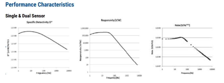

  • michaelkellett
    michaelkellett over 4 years ago in reply to Runzolf +2
    On page 11 of the data sheet you can see that the different devices offered use channel 1 as a non target gas responsive reference channel. This is because the IR source will not give the same output over…

  • michaelkellett
    On page 11 of the data sheet you can see that the different devices offered use channel 1 as a non target gas responsive reference channel.  This is because the IR source will not give the same output over temperature and time.
    To make a working sensor with these devices you need to take into account the variations in IR device output, CO2 absorbtion (which varies with pressure, temperature and water content) and the variations in the IR detectors. Then you will need a way of calibrating the device. When I mentioned a few man years of development to go from a working IR reciever to a working CO2 sensor I wasn't joking.
