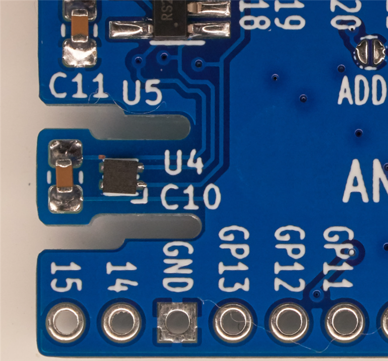

    0 shabaz over 2 years ago in reply to beacon_dave
    From the specs the performance is not much better, it's just different, at zero degrees for the sensor. But I think the problem is, without a reference design, the discrepancy will easily exceed those charts (for instance having the sensor powered up will warm it, or if its on a board then other components or drafts will heat or cool it. I observed that with a SHTxx chip too, where my layout was not the same as the reference board, and the measurement was off by more than the datasheet curve (by about 1-2 degrees from memory). The Sensirion board is their reference design, so should be more accurate - hopefully!
    Edit: This was my layout, but it was not fit for purpose, the measurement was off by several degrees. Subsequently I changed the board shape to more closely reflect the reference design, but I've not tried the new layout yet.

    0 shabaz over 2 years ago in reply to ntewinkel
    Without the reference design (or comparing against known temperatures) I would have had no easy way to know if my board had a discrepancy. Comparing to that, I could easily see my design had quite a large error.
    Also, it's worth maybe not powering the sensor permanently. My first board has 3.3V permanently applied, but that's unnecessary, it could be better powered from a GPIO pin, to reduce heating from the power source.
    Plus, location with respect to other parts. Actually now I look at my (still-incomplete) KiCad project folder, it looks like I aborted having that sensor on the board, i.e. I removed it for the revision 2, simply because of the poor performance in revision 1, after considering proximity to other boards.
