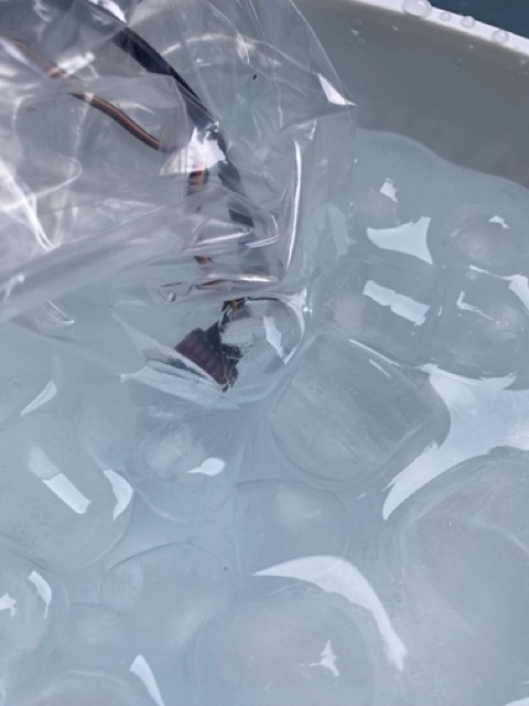

    If they are waterproof you can stick them in a slush of ice and water to get a zero degrees reference. If they aren't waterproof you can put them in a plastic bag in the ice/water mix. If they can take…

    During the ice-water test, you have to be careful not to touch the ice-cubes. They are still colder than zero degC. I learnt this during a thermocouple roadtest.

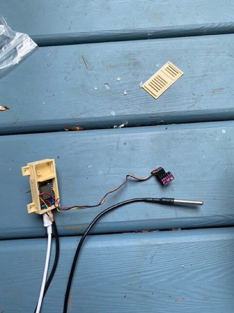

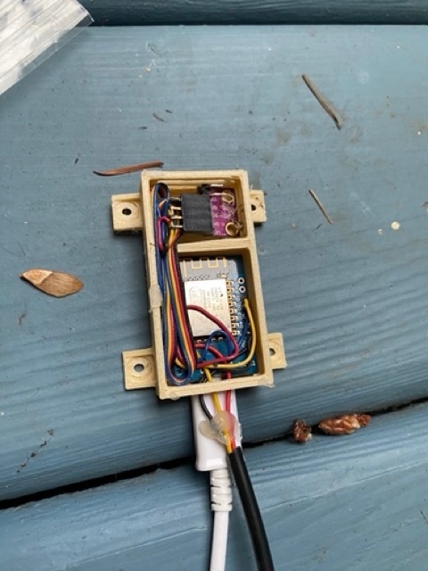

    I think shabaz  was onto something... it looks like the other sensor was maybe getting warmed up? Possibly because the Wemos D1 Mini is right next to it in the enclosure, even though it does have a separation.
    And I was wrong - the other sensor is a BME280, not the DHT I thought I was using in there. Funny, I guess it's been up there long enough for my short memory to keep up with it Laughing
    I tried an ice bath, but it didn't work well. It dipped down close to zero and then I think the bag started floating.

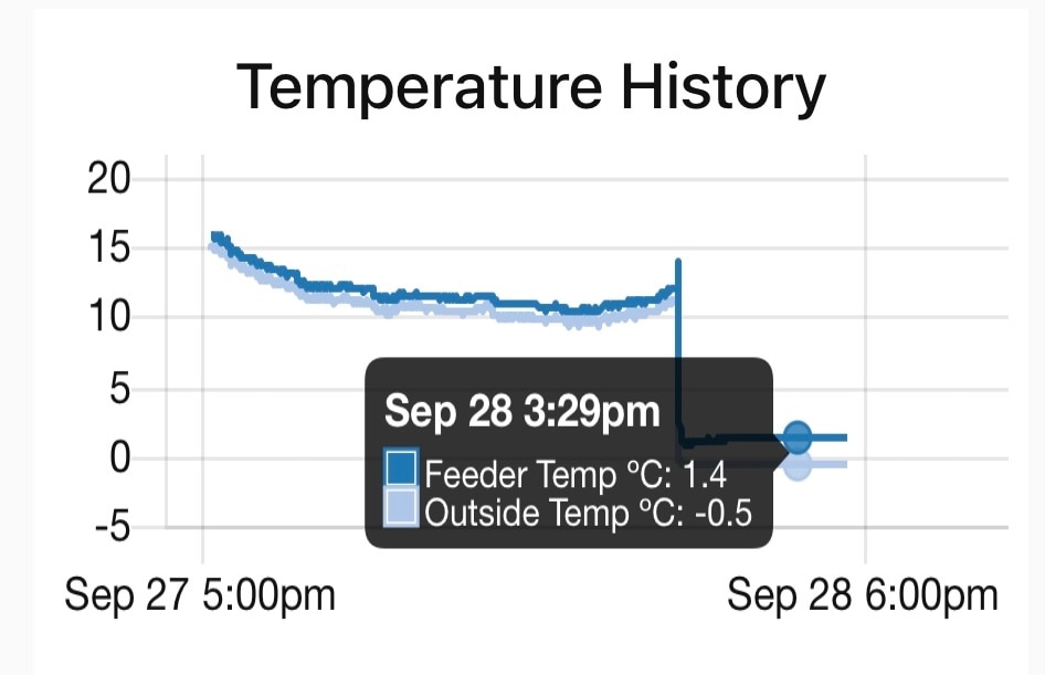

    BUT... once I removed it from the enclosure, the BME280 (light blue line, previously always on top) was recording predictably about a degree lower than the DS18b20 probe.

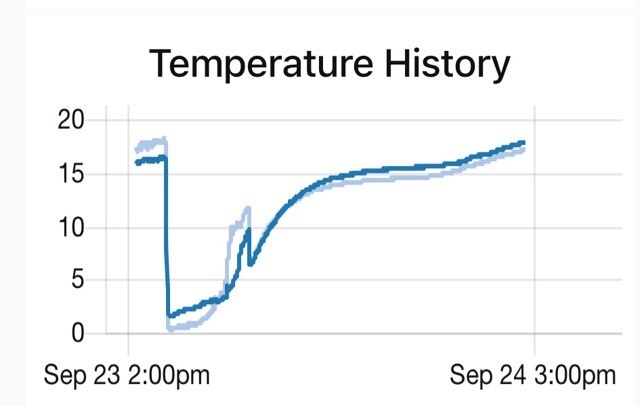

    I had it in the container of water overnight (with the bag clipped down better), and then removed it this morning with the two sensors being side by side in the air afterwards. This is the resulting graph:
    So it looks like the BME280 is probably the accurate one (based on it hitting 0 in the ice bath), with the DS18b20 always recording a degree higher.
    I'll try the ice bath again, this time with more insulation all around, and I'm going to have to print a new enclosure that keeps the BME280 away from the Wemos D1 Mini. After that, if the ice bath result is stable, I'll update the code to just do a simple +/- adjustment.

    0 battlecoder over 2 years ago in reply to ntewinkel
    It looks like the gap is a tad narrower at lower temperatures, but it still seem to remain around a degree almost consistently across the board, so it's probably enough to just subtract that 1 degree difference from the DS18B20, as you said. Fancier math is not going to give you a lot more accuracy considering what we are seeing in those graphs.

    battlecoder said:
    There's definitely a difference at lower temps
    Yes, it went from a one degree difference in the 10 to 20C range to nearly 2 degrees at freezing.
    It’s only for my specific use case for the hummingbird feeder, and freezing is the key thing I’m interested in. Our area might go down to -15C and up to maybe +35C, and those are interesting but not critical.
    I might get more fancy later, but this should do the trick for now.

      Not sure what will happen as the temperature goes up, but that is close enough. Next I’ll have to print a separate enclosure for the bme280 so the warmth of the chip won’t affect it.
