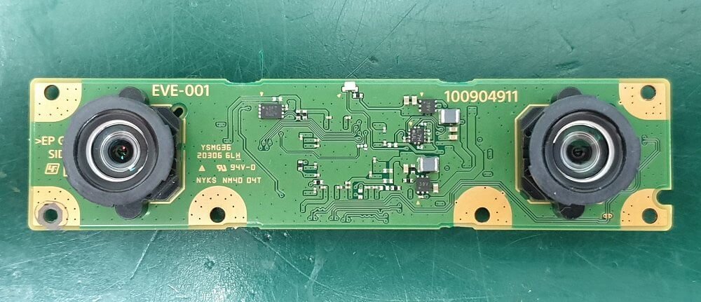

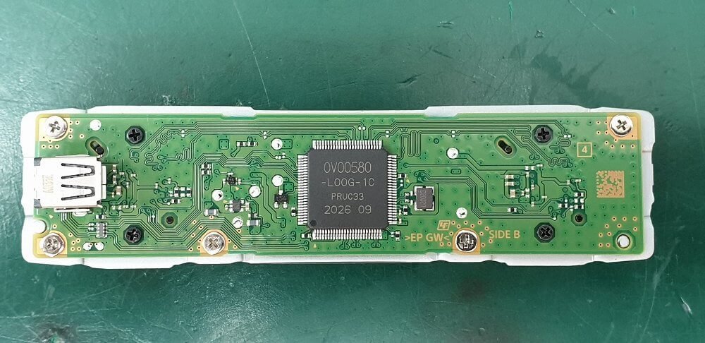

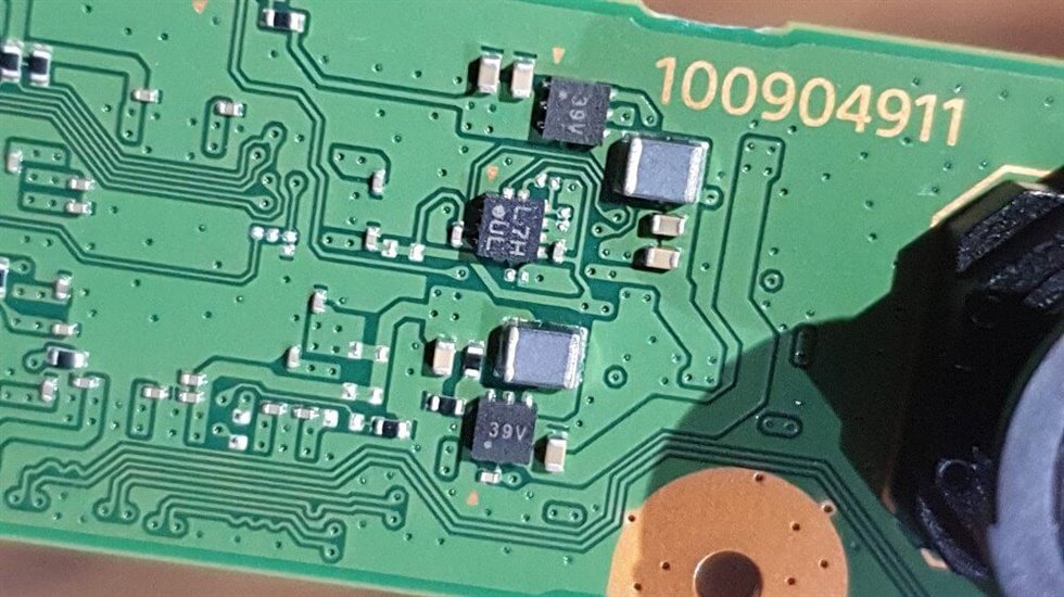

I want to ask the Element14 community for help. I'm trying to study the PS5 camera device in order to use it as a cheap solution for computer vision. There is already a way to upload firmware to the camera via USB on the Internet, but this method is not very convenient, since it requires constantly uploading firmware when connecting the camera to USB and not all devices work with it. I would like to find a more universal solution.
What needs to be found out:

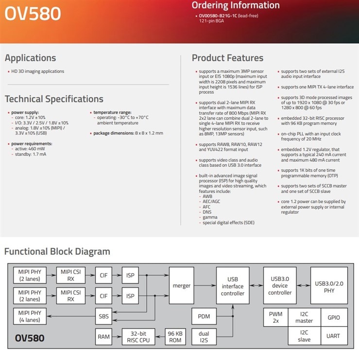

1. What controller is on the camera, and is it possible to flash it somehow? It seems to be OV580 with 32-bit RISC CPU. But I can't find a datasheet for this chip.
2. What elements are used on the board?
If anyone is interested in this camera, join the discussion.

    I do not have devices, but according to info which I shown in project (likely the same you mention) https://github.com/Hackinside/PS5_camera_files , it seems that device has no flash at all. After powering up, PlayStation likely load firmware to some kind of RAM every time it boots. It is pretty common for mass produced device (many Realtek NICs work like this), because when you optimise cost at cent level, flash become pretty expensive. It is because when you have let's say 20 chips in design, it is cheaper to have one large flash, instead of having 20 small flashes in each chip. But then of couse, you need to distribute these firmwares from large flashes to small memories in chips.
    I think the way is to optimize manual steps to make it working when connecting to PC, but it seems that it is long term goal and plans of the mentioned project.

    Possibly you could add a USB mux and microcontroller between the camera and PC, where the microcontroller acts as a USB host and sends the firmware to the camera, before switching the mux over so the PC has USB access to the camera?
    Not a particularly elegant solution, but it's very easily reversible, and should let you use the camera from any device without having to worry about flashing the OV580.

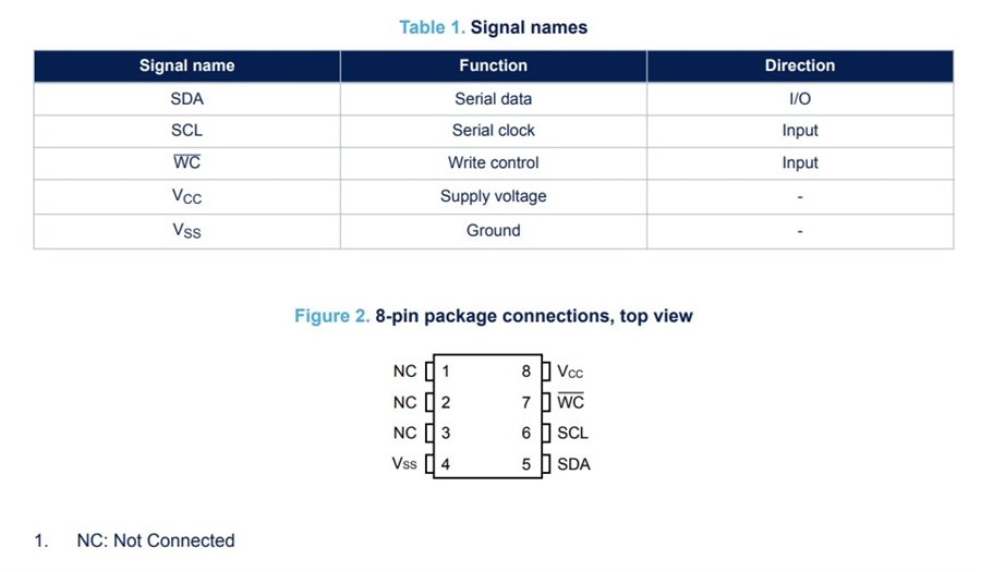

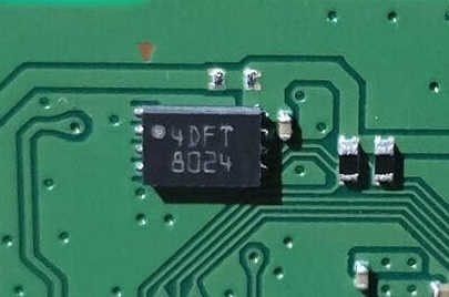

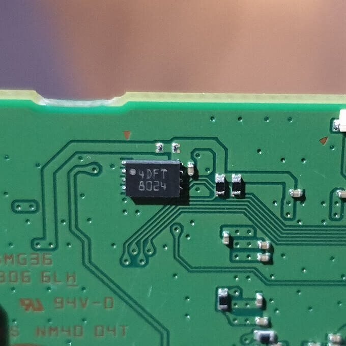

    This element is very similar to EEPROM, even ST M24C16, I think.
    The tracks on the board match the pinout specified in the datasheet for M24C16. Maybe the firmware is located here? What do you think?

    Interesting idea, but I still think if it doesn’t work out to flash the original controller, then try to replace it with some other one or FPGA.

    The OV580 microcontroller also has some ROM. What can be stored there and how to read it?

    I can't answer what kind of solder is above the chip. I will definitely do some probing, but first I wanted to visually identify all the elements. I was hoping that maybe someone from the community had encountered such elements and a microcontroller and could suggest something.
  • misaz
    misaz over 1 year ago in reply to maxpowerr
    You can try to read it. flashrom open source project likely know the protocol. Alternative approach is to observe what main chip reads from it. If you decide to probing, do not probe it at chip pins. Instead probe SDA/SCL at resistors at right side of chip. Easiest way for introductory analysis is scope for detecting type of procol and voltage, then you can use some logic analyzer or since I2C is slow, maybe there is some sniffer for RPI or something like that..

    If you can't google MCU, even somebody will have experience, he/she will likely be restricted by NDA and will not be able to speak about it.
  • maxpowerr
    maxpowerr over 1 year ago in reply to misaz
    Thank you for your advice I really appreciate it. I have a cheap logic analyzer SALEAE LOGIC 24 MHz and also have a T48 programmer I hope I can come up with something with it.
