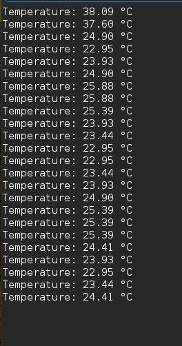

Hello, I just started a project with LM35 (temperature sensors) with Arduino, after mounting it on my breadboard I noticed that the values ​​in the serial monitor are inconsistent and vary in a strange way, for example I get 21°, 20°, 22° 24° successively which is impossible I get the same result with 5 different sensors,  even whern i use a heat source the temperature the values vary also in a strange way and I don't know where the problem is can someone help me please? image imageimage

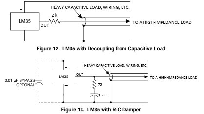

    samiboutgoulla You can try one of the circuits below. They are taken from the LM35 datasheet. The capacitance of your breadboard may be impacting your readings. Still... shabaz's video is very compelling…

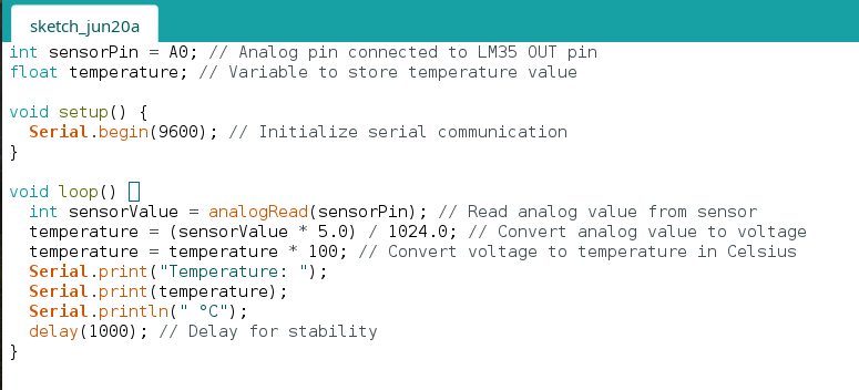

    This means that with 5 LM35s I get strange results, they are not 100% the same values ​​but they are strange and imprecise , i have joined the circut and also the data that i get from serial monitor imageimage

    it seems that for LM35 1 st. C translates to 10mV of output voltage. Considering that (for Atmega) one bit of ADC result at Vref = 5V is about 5mV, typical ADC conversion accuracy is about 1 st.C (2 LSB), with max error of about 2 st. C.
    Maybe switching to internal voltage reference of 1V would bring better accuracy? and adding some Vcc filtering in case when observed variability is caused by Vcc (used as reference) noise?

    docs.arduino.cc/.../
  • JWx
    0 JWx over 1 year ago in reply to JWx
    and change 5.0 to the value of the reference in code...

    The sensor output is 10mV/degree C. The resolution of your ADC is 5000/1024 = 4.88 mV which is equivalent to 0.488 C.
    You would expect to see the readings jump about by at least half a degree. You are taking a reading once per second so I suggest that you filter the signal going in to the ADC. Put a 2k resistor between the sensor output and the ADC input and a capacitor between the ADC input and ground. The capacitor value should be chosen for a 0.5 second time constant C = 0.5/2000 = 25uF (use 22uF).
    This will ensure that no noise above a few Hz will get into the ADC and may well help.
    If you don't have the right parts pretty much any value for R between 1k and 10k should work and any value from 1uF to 100uF for C. (Obviously if you use 10k and 100uF it will respond rather slowly but this probably won't matter.)

    put
    analogReference(INTERNAL);
    in setup, then change sensorValue * 5.0 to something like sensorValue * 1.1
    (reference voltage is about 1.1V (min 1V, max 1.2V) - could be measured for better accuracy)
