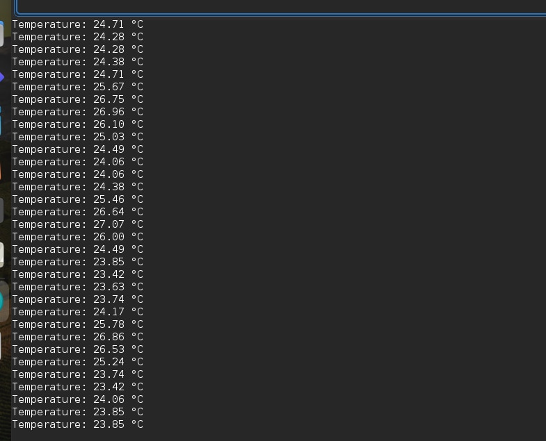

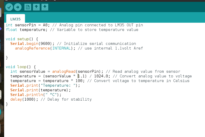

Hello, I just started a project with LM35 (temperature sensors) with Arduino, after mounting it on my breadboard I noticed that the values ​​in the serial monitor are inconsistent and vary in a strange way, for example I get 21°, 20°, 22° 24° successively which is impossible I get the same result with 5 different sensors,  even whern i use a heat source the temperature the values vary also in a strange way and I don't know where the problem is can someone help me please? image imageimage

    so it seem to be  a noise problem - you can add filtering as mentioned by michaelkellett  and/or average the value read (read several times in sequence and calculate an average of them)

    For now you can try averaging the simplest way is:
    average = average + ( (new_result - average) / f)
    The larger the value of f the slower the filter is to respond. average, new_result and f should be declared as floats.
    f = 10.0 is a good starting point.
