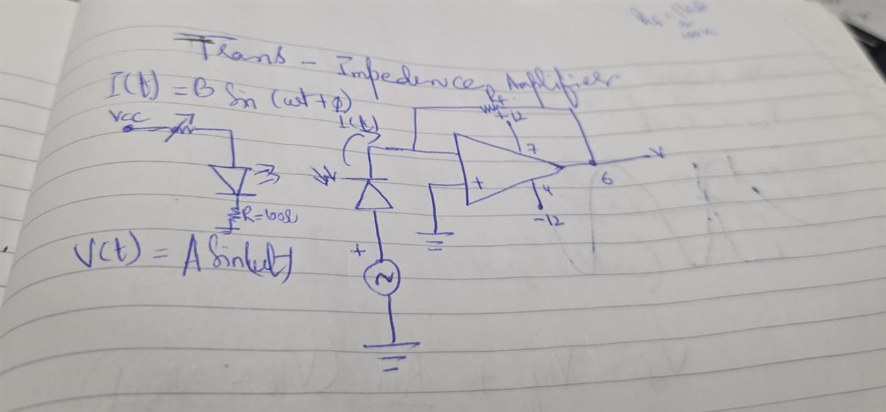

I am currently working on a project to develop a fibre optic dosimetry system. The system uses an organic scintillator (BCF-60), which emits green light at 530 nm, with an active volume of 0.8 mm³.

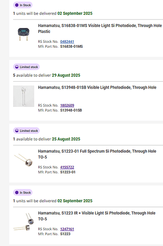

I am in the process of designing a transimpedance amplifier (TIA) circuit using different photodetectors, which I selected based on their spectral response range (360 nm to 900 nm).
Could you please guide me on the key tests I should perform to help select the most reliable and suitable photodiode for my application?
I am planning to test the TIA response using different LEDs (blue, green, red, and IR). I would appreciate your suggestions on any additional quick and effective tests I could perform to further characterize the photodiodes for use in my dosimetry system.
In TIA cct I used Rf 100k and 741 opamp.
Kindly please guide..

    It would be hard to think of a less suitable op-amp than the 741 to use with a fancy photo-diode. (I picked one of your selection at random and noticed that it costs £17.)
    Why are you biasing the photo diode with an AC source ?
    I suspect that you are not equipped to measure the reliability of the photo diode - just buy from a reputable source and operate it well within ratings for reverse bias etc.
    Do some reading about photo diode trans impedance amplifiers (DuckDuckGo or Google it).
    Here are some starters:
    https://www.ti.com/lit/pdf/tidu535
    www.ti.com/.../SSZTBC4
    https://www.allaboutcircuits.com/technical-articles/design-tips-for-photodiode-amplifiers/
    If possible you should start by measuring the photo current coming out of your test devices before you attempt to design an amplifier of your own.

    I plan to use the OPA657 op-amp, as the 741 op-amp has higher noise and is not suitable for this application.
    if you don't mind, I would appreciate your guidance on how to characterize different photodiodes to help me select the most suitable one for my project.

    You've already narrowed it down to the selection you listed, so maybe just try your top two or three selections, see which one meets your needs?
    What I don't understand, is you've mentioned 0.8 mm3 volume, yet from the photos, each of the selected photo diodes look large (I have not looked at their datasheets). However much light are you expecting? Is it an extremely tiny amount? If so then maybe SPADs are a better choice than photodiode? See here:
     The Use of SiPMs in the Life Sciences
    I could be very wrong since I'm not knowledgeable in your subject area.

    This is a tricky problem (and a long way from what I know much about which is gas detection with NDIR detectors)
    You need to somehow work out how much power gets into the fibre, and then how well you can couple the PD into the fibre.
    The first bit will be hard and the only hope is literature scouring or to talk to someone with direct experience.

    I'm assuming that you need to be able to plug the end of the fibre into some kind of connector to the PD so you can use the same PD with lots of different fibres. This will mean less good coupling and you don't really want a big PD in a TO5 can.
