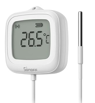

As a result, I wanted to both have a quick way to check the current temperature, while having a history of said temperatures and to get this, I installed a zigbee sensor with a wired temperature probe like this:

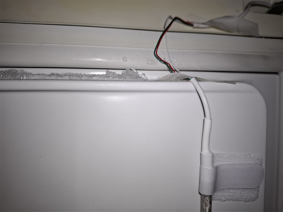

This works fine but the probe cable is quite thick (3mm) leading to air leakage at the location where the cable is getting through the door seal.
Using a small scalpel, I was able to strip the outer insulation to get access to the three inner cables which are way thinner, hoping this would restore the seal effectiveness.
Sadly, while this is better, this is still not enough, ice is building up inside, starting along the three cables as can be seen here:
I had removed most of it two days before taking this picture and it's already back.

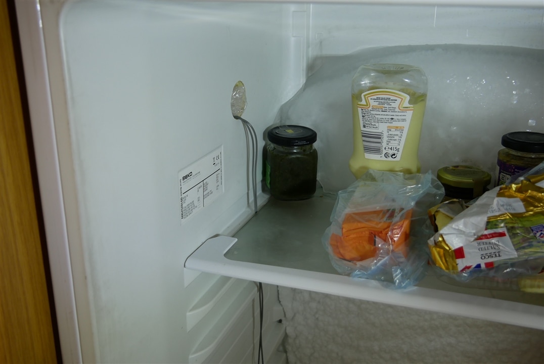

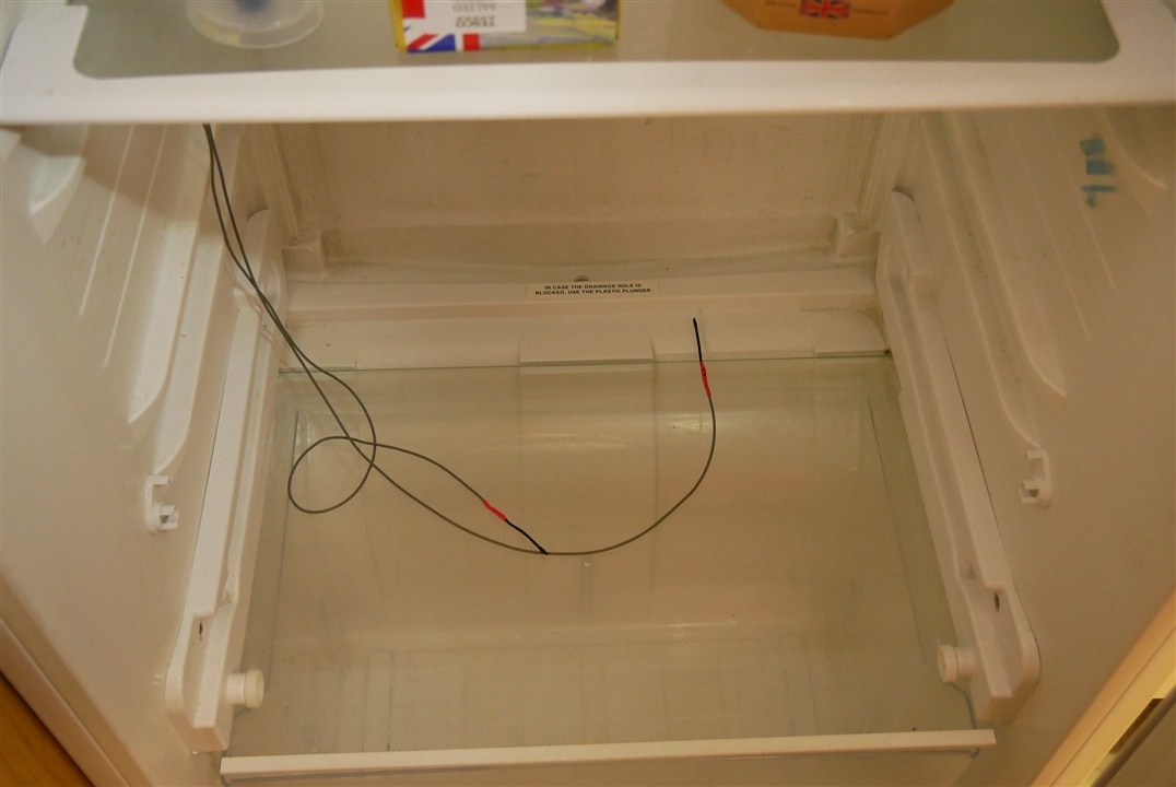

    Drilled hole in the side of fridge - sealed around two thermistor wires with bubble wrap. Note that this is a working fridge with a slight auto defrost issue.
    The sensors - one is for the fridge in general and one for the load - no load at the moment so they are both just resting on the floor.

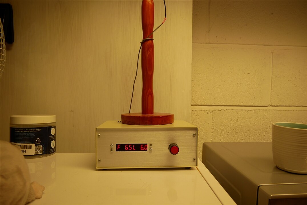

    The fridge controller - the display is telling me that the F(ridge) temperature is 6.5 and the L(oad) temperature is 6.0. (Warm because I just had the door open for  a minute or two to take pictures.
    The controller display cycles and also shows the ambient and compressor temperatures and if the compressor is on or off.
    I modified the fridge and made the controller for a job about 10 years ago but now I just use the fridge to keep my cheese and butter cool and my mint sauce frozen.

    obones 24 days ago
    I suddenly remembered that I had enameled copper wire lying around for years after another project, and with a diameter of 0.3mm, it's really thin.
    So before investing into a truly wireless solution, I decided to cut the existing cable and create an extension made of three strands of that enameled wire.
    Adding 10 cm to the total length did not change the read temperature and ice build up has not come back in any way that my eye can see.
    That puts and end to my over engineering idea, but it's nice to be pragmatic at times.
