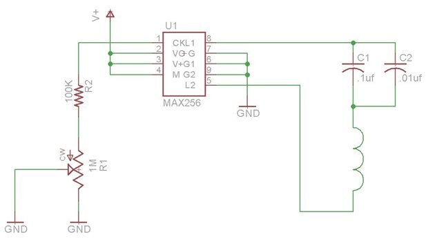

Here is the simple 5V power oscillator circuit that drives a printed coil that has 9 turns on it in a square spiral:
There are links to some PCB spiral coil inductance calculators in the links section.
The MAX256 is a neat little 3W chip that includes an oscillator and a power H-bridge driver designed to drive the primary side of transformers.

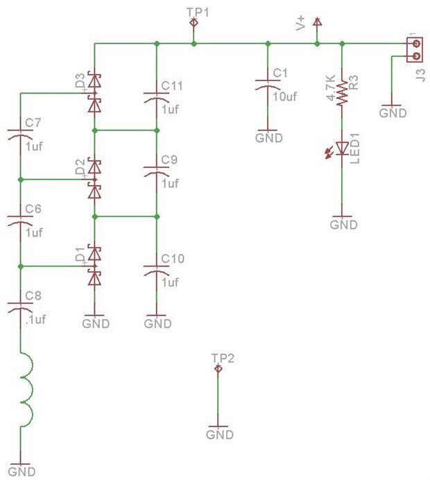

Here is the Power scavenging circuit, also with a 9 turn printed coil in a square spiral.
It has a charge pump to convert the AC input signal to DC and boost it to a higher voltage:

    No, but it will probably be necessary to figure out the power when I expand the system with Bluetooth. I know the oscillator draws about 3 Watts (I didn't build in a way to adjust the power) and I smoked…

    No, but it will probably be necessary to figure out the power when I expand the system with Bluetooth. I know the oscillator draws about 3 Watts (I didn't build in a way to adjust the power) and I smoked several (200 mA) Schottky diodes in the receiver charge pump before replacing them with 1 A Schottky diodes. When the 2 "antennas" are close together and it is adjusted to resonance there is pretty good coupling, but so far it is just incidental observation. It seems to have much more capacity than  I need at the moment. One issue with the system is that the DC converter needs 3 volts to operate, and of course the receiver voltage goes down as the load increases, so even though the system may transfer more power at lower voltage, I can't use it.
    Because of the resonance and the charge pump, the received voltage can far exceed the original oscillator supply voltage.
    I have a DC converter that works down to 1.2 Volts, that I was planning to use, but it stops regulating when the voltage exceeds 5 V. For me it is more a matter of how far I can separate the antennas and still get enough power through, because the power transfer obviously is highly dependent on the separation distance.
