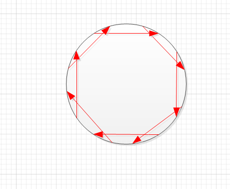

    pettitda over 9 years ago in reply to jw0752
    I guess I didn't make it clear that the pool is round.  So, there are no straight edges.  However, I might be able to use multiple pairs of sensors arranged in a pattern (see below).  Of course, it wouldn't detect something entering the center of the pool, but that is an unlikely occurrence.  I will calculate how many sensors it would require to cover a 27 foot diameter pool out to say 2 foot with gaps no bigger than 6 inches, but I think it must be large.
