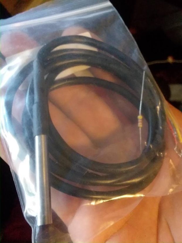

    There is a high temp version of the DS18B20.
  • ninjatrent
    ninjatrent over 8 years ago in reply to mcb1
    I just purchased a waterproof DS18B20.
    It cost about US$10

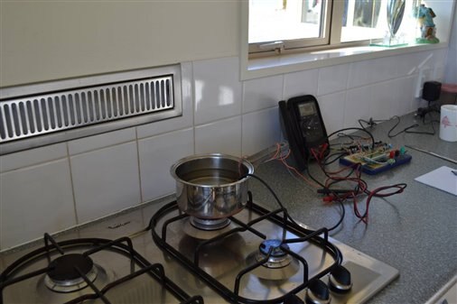

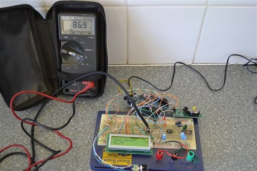

    mcb1 over 8 years ago in reply to koudelad
    where I would measure an engine coolant temperature
    I've done one of these and I used an "off the shelf" sensor and mapped the temperature spots I was interested in.
    Here is the closest I get to cooking.

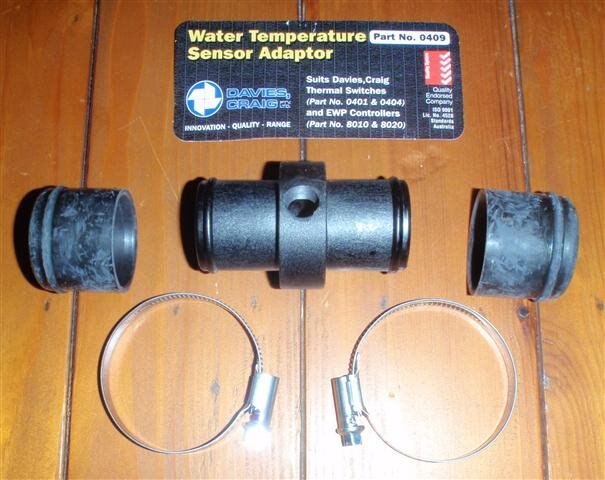

    I did it this way because trying to seal the sensor would be a problem and with the engine bay temperatures, plastic (gland nuts) wasn't going to stand a chance.
    If I was going to repeat it, I'd consider inserting a pipe into the radiator hose and weld a sealed tube into the water flow, thereby creating a watertight and pressure tight interface.
    You can also buy these (this was from Australia). it is intended to provide a threaded fitting.
    mcb1 over 8 years ago in reply to ninjatrent
    I've always purchased mine from Terry King at Yourduino.
    Waterproof DS18B20 stainless steel encapsulated temperature sensor 1M Cable
    Because there is a small freight charge, I tend to buy more than one at a time.
