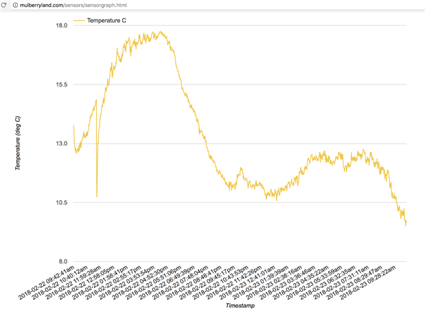

    Here's a graph, which shows the heater is having a good effect, switched with the KSD9700, but I think the insulation could use some work!
    I'll add a blog post soon about the ESP-01 data logger I set up to gather that data. ps, that url is still live, and showing the other same setup which is not nearly as neat a graph.

    Thank you for that, I do think that might be the issue I'm seeing with the second setup. I put the USB-handwarmer heater and the sensor in the same relative position as in setup 1 (see graph replied to Gene above), but I wonder if maybe the insulation is separating them better in the first setup.

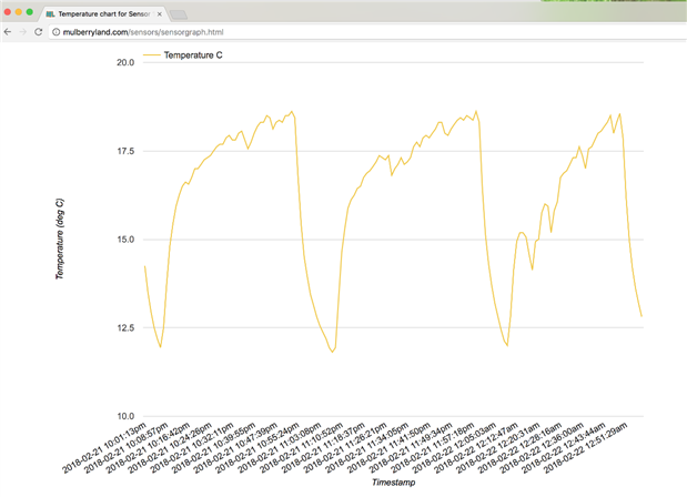

    This (graph below) is what's happening in the second setup that is causing me to wonder about the second KSD9700, but you might be right about placement. I think I'll try moving the temperature probe (for the graph data) to right beside the temperature switch to see if that changes the numbers.
    The above graph for setup1 has a roughly 1-hour cycle. Setup2 seems to have a roughly 12 hour cycle, and it looks like the heater is on and off a lot.

    Aha! I just went out to more precisely place the temperature probe used for logging, and noticed I had it jammed between the container and the temperature switch. sigh. so basically the switch was using an indirect temperature, which might explain the fluctuations.
    I've repositioned the probe to be right beside the switch now, so I'm hoping for better numbers.
    Data has been reset.
    Stay tuned for the live action as the numbers roll in minute by minute!
    http://mulberryland.com/sensors/sensorgraph.html
    Hmm, at 6 degrees it's not looking very good so far... I better check that the heater is still plugged in.
    For science!
    edit: yes looks like heater wasn't plugged in properly. funny you can see where I adjusted it in the graph image
    edit2: sigh. it doesn't look any better. I'm thinking the KSD9700 is faulty and my previous "unplug-replug" maybe shook it enough to briefly turn it on.
