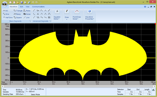

The Formula (s) the Scientists agreed to implement where the following, all four of them are needed
2*sqrt((‑abs(abs(x)-1))*abs(3-abs(x))/((abs(x)-1)*(3-abs(x))))*(1+abs(abs(x)-3)/(abs(x)-3))*sqrt(1-(x/7)^2)+(5+0.97*(abs(x-0.5)+abs(x+0.5))-3*(abs(x-0.75)+abs(x+0.75)))*(1+abs(1-abs(x))/(1-abs(x)))
(‑3)*sqrt(1-(x/7)^2)*sqrt(abs(abs(x)-4)/(abs(x)-4))
abs(x/2)-0.0913722*x^2-3+sqrt(1-(abs(abs(x)-2)-1)^2)3+sqrt1)^2)
(2.71052+1.5-0.5*abs(x)-1.35526*sqrt(4-(abs(x)-1)^2))*sqrt(abs(abs(x)-1)/(abs(x)-1))+0.9
(For full disclosure the Bat team found the formula Here :- https://www.google.ca/?gfe_rd=cr&ei=Lr1uU5KhJ8OC8QfrjoHgDA#aq=f&aqi=&aql=&gs_sm=3&gs_upl=1000l1000l0l1996l1l0l0l0l0l0l0l… )
Scientist 2...I know, convert it to a square wave and send it with the amplitude and offset changing only, if the bad guys see it they will think its just test data... but how!!
Scientist 1... See Sharp
1/2 hr later... I cant find anyone called Sharp ?.. (Faint Slap is heard in the background)
C# silly, not See Sharp, even if you did find Sharp, he does not have the clearance for this
So a bit of programming later and we have some data..Yaaaaa

OK, now were getting somewhere, 10,000 data points that can be transmitted at almost any speed, the bat sensors can decode at the other end knowing the formula and oh... um what about Alfred, he needs a screen that looks like well something ordinary
an Oscilloscope shouts scientist number 3, Mr Wayne is always playing with them and so it would be normal to see many at Wayne manor just lying around... Boys and their Toys image
Ok, testing time, where's the generator
Holy Bat cave , its gone already, its on the Bat net but over in the Bat cave
What's this!, someone has left a secret package at he lab, its not ticking so lets open it
wow, everyone gasps in Awe, its the Agilent BenchVue software, this is great, we can send the data remotely to the generator at the bat cave for testing and batman can deliver it later to GCPD... Perfect
