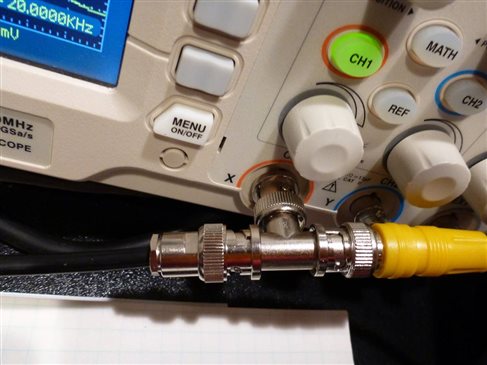

Setup images
Initial measurement of RG58 Coax and then the Math's
this is the RG58 scope trace, period between pulse and reflection is 64.8nS which with a velocity factor of 66% equates to 21.03 feet. When I measured the cable with a tape it measured 20.79 feet, allowing for about 3inches of "T" connector, that's a pretty accurate measurement
image imageimage
Sorry I have not added cursors to my scope software yet
Oh no, Ohms law seems to be broken...
Measuring and then calculating the length of RG6 Coax using TDR with the 33622A AWG
this is the RG6 scope trace,(Scope settings are the same as before) period between pulse and reflection is 61.8nS which with a velocity factor of 81% equates to 24.61 feet. When I measured the cable with a tape it measured 24.93feet, allowing for about 3 inches of "T" connector, that's a pretty accurate measurement
Measuring and Calculating the length of UTP cable
Screen Capture for UTP Cable, only difference is the timing is now 50nS
Period between pulse and reflection is 480nS which with a velocity factor of 73% equates to 172.3 feet. When I measured the cable with a tape it measured 174.5feet, that's a pretty accurate measurement
