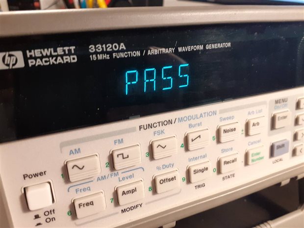

From the service manual I found out that holding down Shift while powering the unit on would run a self-diagnostics test. The test passed without any complaints, a good sign!
The VFD is nice and bright too, telling me that this HP haven't seen much use.

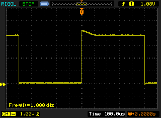

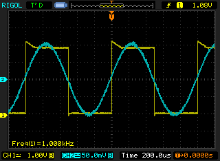

I unplugged the unit and checked the output resistance to ground with an ohmmeter, assuming that it's terminated with 50 ohm, but it just read open circuit. While I was at it I also checked the sync output, which read about 130 kilo ohms. I think it should be in the 10-100 kilos of ohm range for a digital output, so that reading seemed good to me. Now that I'm thinking that the sync output isn't broken I checked the output from it with my buddy Rigol again and saw a 1 kHz square wave, with the instrument set to output a 1 kHz sine.
The sync signal even followed along as I changed the frequency on the function generator. This is promising because the sync output is generated from the signal output by a comparator in this mode, meaning that somewhere inside the output signal is being generated.

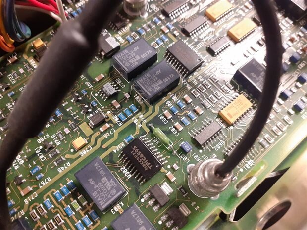

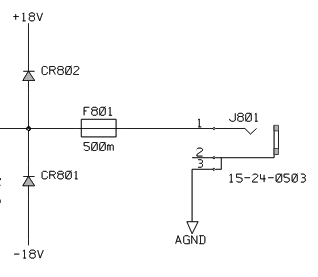

To double check my assumptions about the output termination I went to the schematics in the service manual to see if it was indeed terminated with 50 ohm. To my surprise I saw that there was a fuse on the output, with diodes for voltage protection.
The first point in the service manual's operating checklist for when the output is inoperative is to check if the output reads over 100 ohms, if it does you should check fuse F801.
F801 is a 0.5 A fuse and CR801 together with CR802 protect against over- and under-voltage on the output. The 50 ohm terminator I was trying to see with the ohmmeter is behind a switchable attenuator, where it is connected to the output of an amplifier and is made out of eight 100 ohm resistors (four parallel circuits of two resistors in series). Using my ohmmeter I could confirm that the fuse was indeed open.

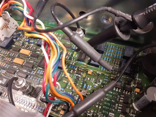

Using the scope to look for a signal
Since F801 is the last component before the output I hooked onto one side of it with my oscilloscope probe, but there was no output. However, much to my delight, there was a signal when I hooked the probe onto the other side of F801! For some reason it's never the first side you try?
The 1 kHz sine was indeed being generated!

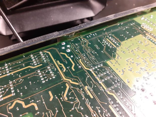

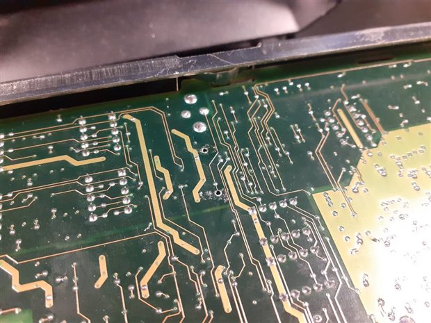

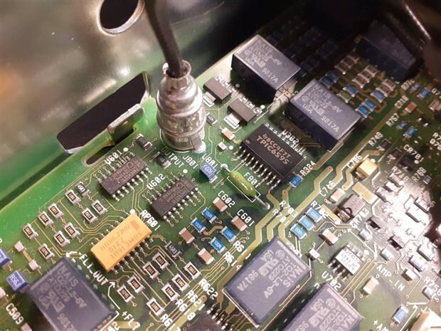

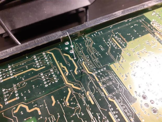

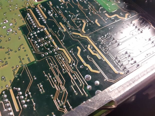

After I figured out how to remove the handle and bought the correct size torx bits, opening up the unit was very easy. The whole cover slides off after the rear bumper is removed. Replacing the fuse was very easy since the PCB is exposed on the underside and doesn't have to be removed.
{gallery} Soldering in a new fuse
The fuse inside the HP.
The pins were easily accessible from the underside of the unit.

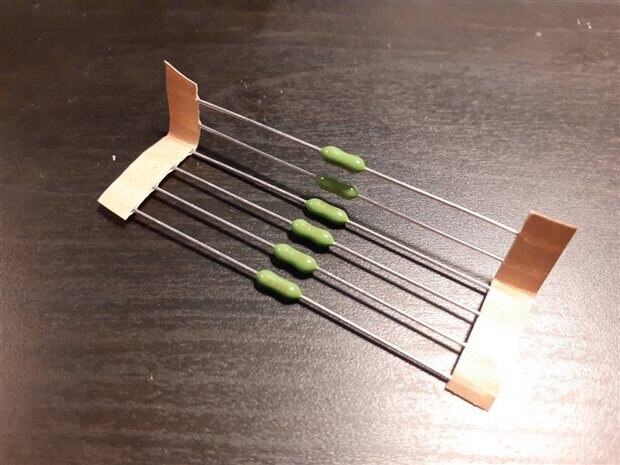

The new 0.5 A ultra fast Littelfuse fuses.
The solder sucker left a mess, but it's now ready for a new fuse.
New fuse soldered in!
Legs snipped and board cleaned with IPA.
A brand new fuse, looking dapper while being a proper short!

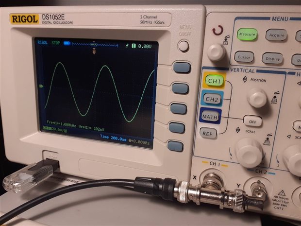

Hooking the BNC cable from the function generator into a T-splitter together with a 50 ohm terminator my buddy Rigol now showed the correct amplitude, 100 mV peak-to-peak. The different waveshapes all looked fine too, changing the frequency worked too.
