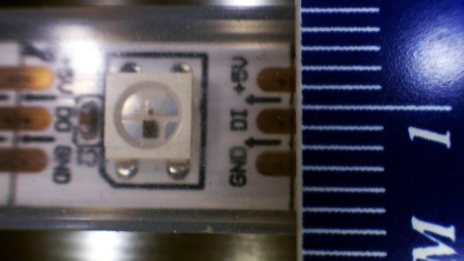

Each device in the string draws current from the supply in proportion to the intensity setting of each LED in the device.  The amount of current drawn by each device is about 12 mA for a mid-brightness color selection.  A fully illuminated 4m string can draw >3A of DC current.  This amount of current draw can have an undesired effect on the appearance of the lighting effect.  The copper traces that convey power to each device are about 1 mm wide and they have a measurable resistance over 4m.  See photo below to get an idea of trace width.
After nulling out test lead resistance, the resistance of the 4 m long power supply copper trace is 600 mΩ.  At 3 A that resistance alone will create a 1.8 V drop in supply voltage.  There is additional resistance in the the ground lead, in the solder joints and in the wire bonds within each device.  The net result is that under high brightness conditions, LEDs near the end of the chain receive significantly lower supply voltage and this makes them appear noticeably dimmer than LEDs at the beginning of the chain.
