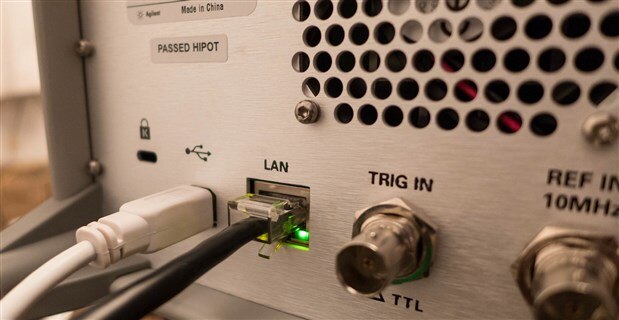

The SA is supplied with some nice client software described below but it is also possible to use third party software or make your own. It integrates into existing test beds using a supplied library discussed below.
This post briefly examines the connectivity options and how to programmatically control and manage the SA.

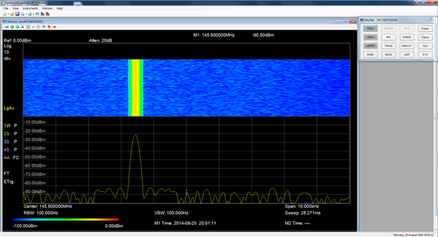

Agilent Remote Control Software
Here is an example screenshot from the client software (known as Agilent BSA PC Software) that comes with the N9322C SA:
Once the software is installed, it is a quick process to get it working with the spectrum analyzer. It auto-detects the SA if it is plugged into a USB port on the PC, or if the SA is in the local area network. See the screenshots further below for further information.
The client software is fast and is not an identical repeat of the graphical user interface on the instrument. Instead, it makes the best use of the PC screen, scales up and allows you to use a mouse to drag to position markers quickly. Here is a very short (1 minute) video showing the basic spectrum analyzer view, a spectrogram view and manual marker positioning (there are auto peak detect options but I wanted to show the mouse drag behaviour):
The video above shows the screen scaled down, however on a large monitor the image scales gracefully as can be seen in this screenshot:
The BSA PC software is a very nice example of well executed remote control client software. I wouldn’t say it is perfect (and Linux and Mac client software is not available) however I can see it being the single most important application for most users to get installed if they plan on using this spectrum analyzer. It won’t be for everyone (some people may require third party software such as NI LabView for logging or post-processing purposes) but for design engineers the BSA PC software is great – it is quick and easy to use.
Although not explored here, the BSA PC software also allows the export of data into CSV files for processing using software such as Excel or MATLAB or GNU Octave, and for accessing files stored on the spectrum analyzer too.

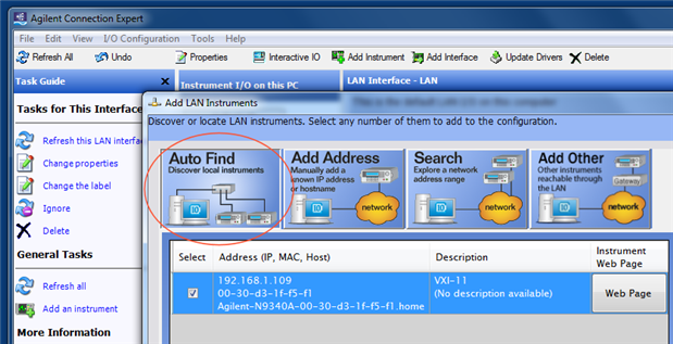

Here is how to get it working:
1. Install MinGW
2. Install Agilent IO Libraries Suite (it is on the supplied CD)

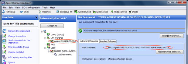

3. From the Windows Start button, run Agilent Connection Expert to get the instrument name (see the earlier screenshot above)
4. Edit the test program so that it contains the instrument name
