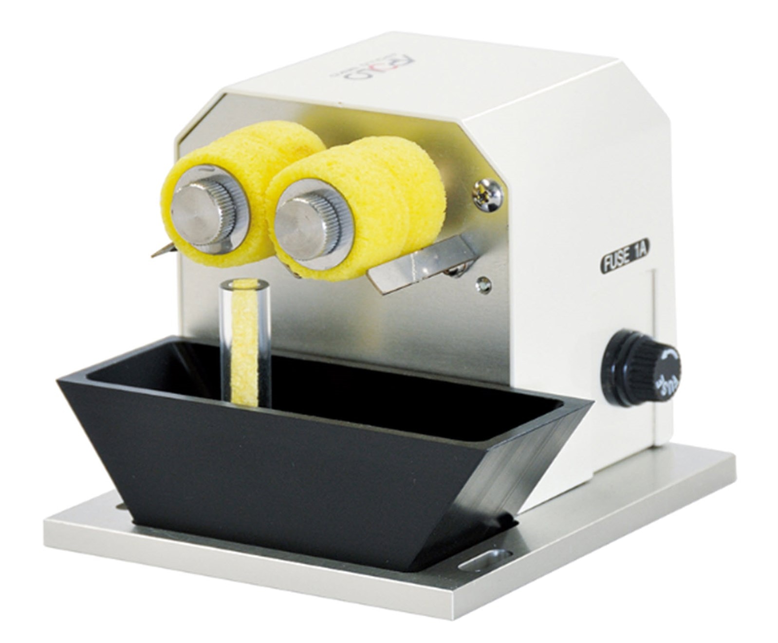

    shabaz over 1 year ago in reply to Gough Lui
    Nice, looking forward to seeing the Movement challenge project!
    I googled around and found this photo of an automatic sponge cleaner for tips. This is by Apollo Seiko, for robots.
    I don't know where the water comes from, maybe it squirts from the tube at the bottom like a little fountain? Although, why that tube contains sponge inside, I don't know.
    Jan Cumps over 1 year ago in reply to shabaz
    I think it is a wick. It can soak up water from the container, and touch one of the rolls when not in action. Because of absorption forces, the water would spread across both rolls. It would remove the need for a pump.
    That's my theory.
    Jan Cumps over 1 year ago in reply to Jan Cumps
    ... looks like I'm not far off:
    shabaz over 1 year ago in reply to Jan Cumps
    Nice.. simple and clever!
