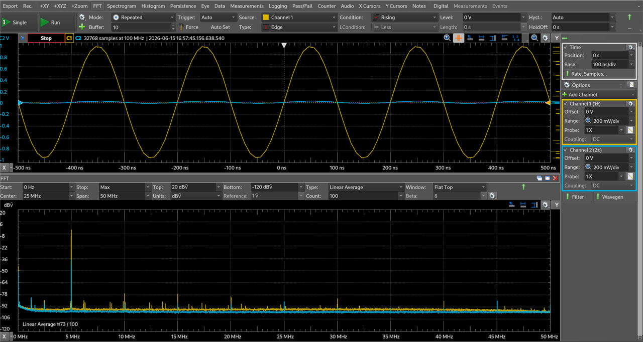

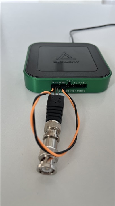

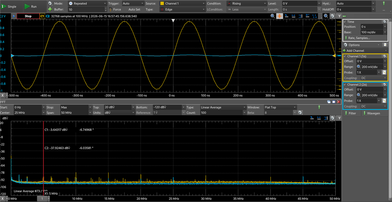

To evaluate this parameter, the channel 1 of the signal generator was configured to produce a 1 Vpp signal at 5 MHz. The generator output was connected to channel 1 of the oscilloscope, and channel 2 was terminated with a 50 Ω load. The signals on both oscilloscope channels were measured, and their FFTs were calculated. In the first scenario, Dupont wires were used. The setup and measurement results are presented below.
The amplitude of the 5 MHz component was -3.64 dBV on channel 1 and -37.92 dBV on channel 2. The measured crosstalk between the oscilloscope channels was therefore approximately -34.3 dBV.

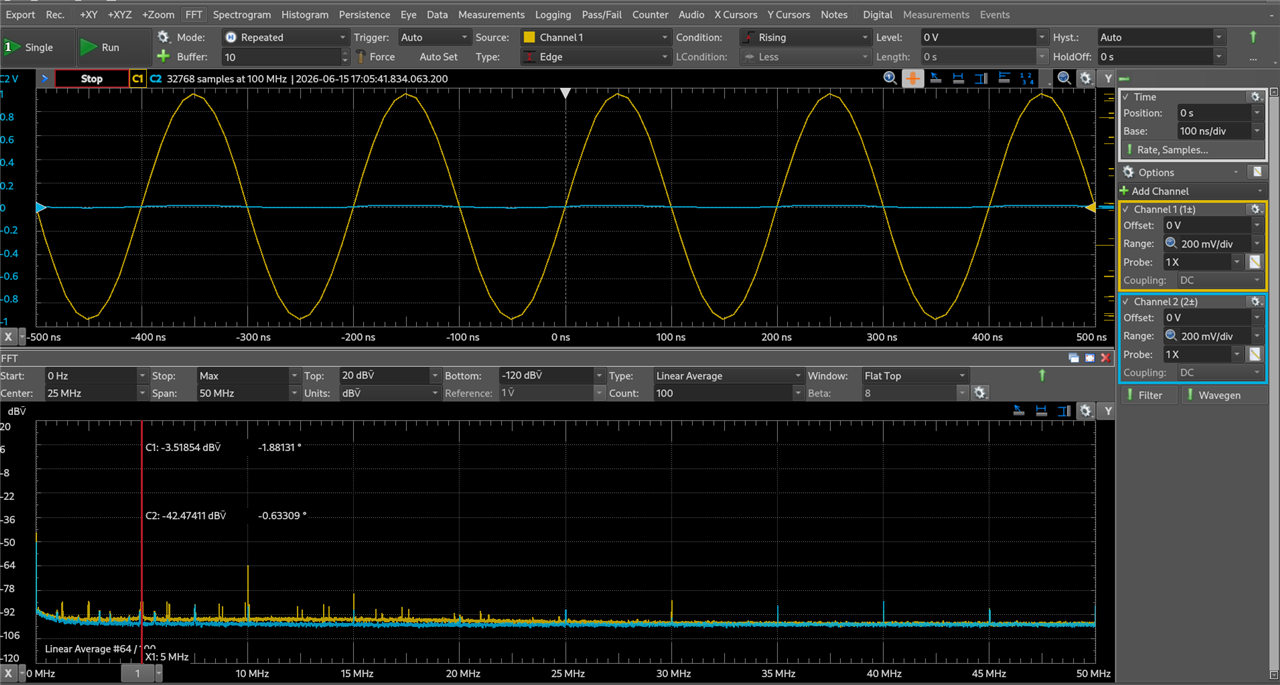

The similar measurement was done for case of usage of the BNC adapter. The setup and measurement results are presented below.
The amplitude of the 5 MHz component was -3.52 dBV on channel 1 and -42.47 dBV on channel 2. Therefore, the measured crosstalk was approximately -39.0 dBV. Compared to the measurement performed using Dupont wires, the BNC adapter reduced the observed crosstalk by approximately 4.7 dBV.
