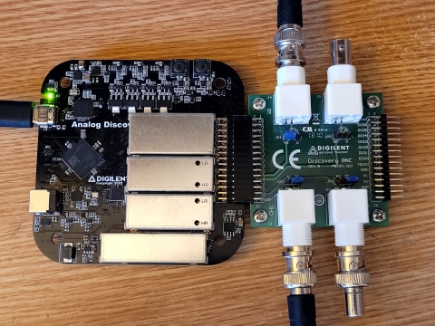

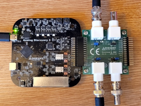

Test setup
Analog Discovery 3 with connected BNC adapter without connected any wire to the adapter. Measured voltage peak to peak, RMS and FFT.

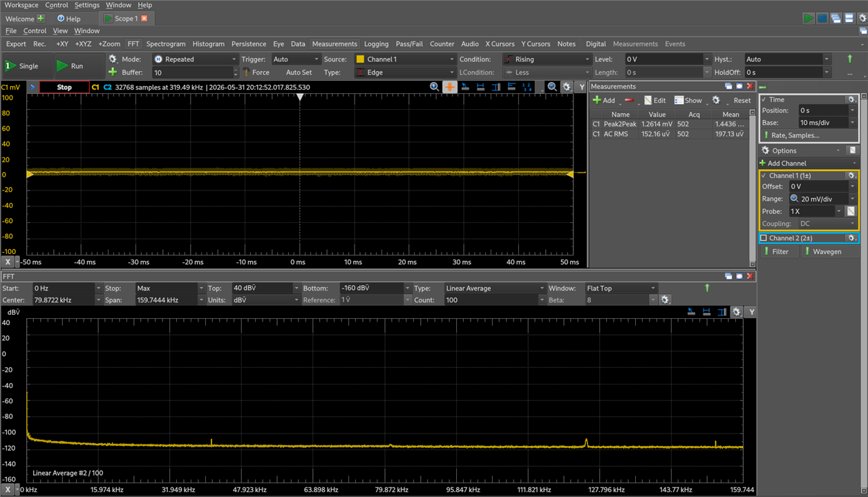

Scenario 1
The notebook is powered only by a internal battery with connected AD3.

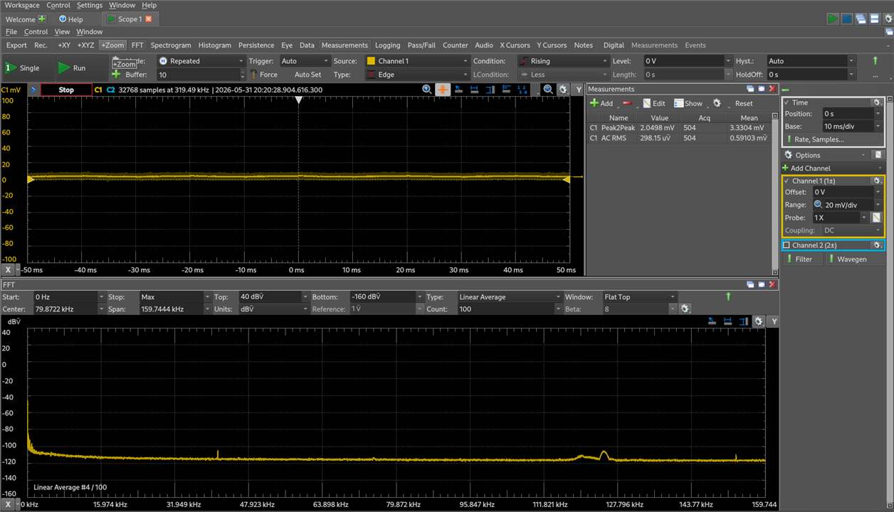

Scenario 4
The notebook is powered only by a powerbank with connected AD3.
Results
Scenario Vp2p_mean [mV] Vrms_mean [mV]
1 1.44 0.20
2 10.70 2.26
3 16.62 2.42
4 3.34 0.59
The best results are when AD3 is powered only by only from a notebook or an external powerbank.
