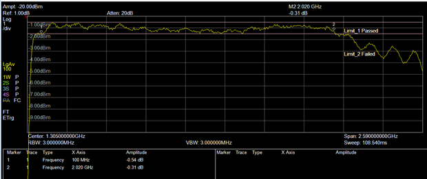

The gain was measured by connecting the tracking generator output to the amplifier input, and connecting the amplifier output to the spectrum analyzer input via a 15dB attenuator.
Since the MGA-30889 is supposed to provide approximately 15dB of gain, the 15dB attenuator would mean I should see around zero dB of gain. The SA will handle a higher input before damage occurs, but unless there is a good reason to remove the attenuator, it’s best to always be extra-safe and use it.
The screenshot below shows the output. The y-axis is set to 1dB per division. As can be seen, the gain was flat within +-0.5dB (indicated by the pink lines) for a frequency range of about 100MHz to beyond 2GHz. The SA can be programmed to alarm when limits are exceeded; this would be ideal for automated test scenarios.
The particular design that I chose from the datasheet should be capable of +-0.25dB of flatness from 200MHz to 2.6GHz, so my PCB layout and component selection (I used what I already had and did not purchase the exact parts specified in the datasheet) has had a negative effect, and the lesson is that a lot of care is needed to construct circuits to function in the multi-GHz range. I’d actually originally intended the board to be used for a 160MHz amplifier. I want the amplifier for 868MHz, so it exceeds the requirement, and it is good to know that the current board can be used to around 2GHz, and beyond this with some degradation.

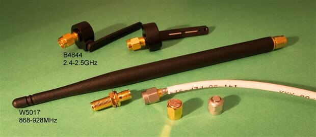

With the calibration complete, I removed the 50 ohm load, and replaced it with an antenna. Here are some antennas that I tried. These two are intended for 868MHz operation, and are manufactured by Anaren, model 66089-080666089-0806 and 66089-083066089-0830.
The photo below shows some more antennas that were tested, manufactured by Pulse Electronics and Antenova.
