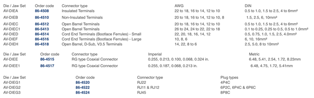

I opted to purchase the 6 dies set along with steel frame and then upgraded to the aluminium frames as seen above. The set came with a guide to all the different dies available, which is very comprehensive. A total of 40 different dies are available for the crimpers ranging from dies for specialist German terminal crimps, co-axial crimps, RJ Plug Crimps, solar crimps through to the standard insulated and uninsulated crimps and ferrules. The following table shows the dies that I have found available in the UK, but does not cover the full range available in the guide.

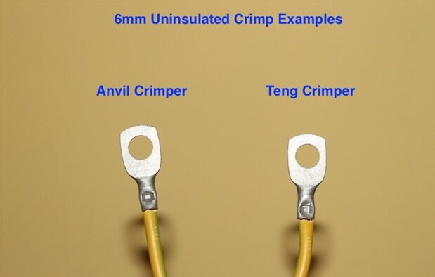

Uninsulated Lug Crimps
As with the insulated crimps, the Teng crimpers produced a wider and deeper indentation into the barrels of uninsulated lugs giving the impression of a sturdier crimp. On longer barrelled crimps you would always have the option of crimping a second indentation to provide extra security, but I only had short barrelled crimps available. On this occasion, the Anvil crimper created the more circular crimp and the Teng crimper flattened the barrel more.
