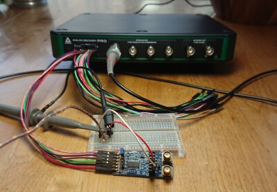

Plug the BNC connector of the scope probe into Oscilloscope Channel 1 and the MTE cable into the digital MTE connector. Connect the DIO channels, ground, and VIO from the Analog Discovery Pro to the PmodAD5 as shown in the below image. Connect the Analog Discovery Pro to a host computer via USB. The DIO channel connections are provided for reference below.
  • DIO0 connected to pin 1 on the Pmod AD5
  • DIO1 connected to pin 4 on the Pmod AD5
  • DIO2 connected to pin 2 on the Pmod AD5
  • DIO3 connected to pin 3 on the Pmod AD5
