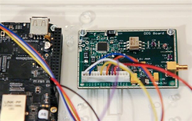

This post is about building a frequency synthesiser for various uses such as for a home lab or as a module for a larger project. The implementation can be useful from a few tens of kHz up to 160MHz; not anywhere near the capabilities of a commercial signal generator, but still very usable. It primarily generates sine waves and square waves but can also handle some forms of modulation and controlled sweeps. This should cover many use-cases, particularly radio related. So far, single tone, adjustable amplitude and frequency modulation (FM) has been implemented in the code.
Even if you already have a signal generator, one is never enough. There are many scenarios where more than a single device is needed so an additional one can be a useful thing to have.
A video of it in action (using a radio to test it) is further below. The photo here shows what it looks like, connected up to a BeagleBone Black (BBB) in this case. The white connector at the bottom is used to connect to the BBB for power and control purposes (just a few pins are used from the connector, not all have to be wired up). The coax connector on the right is the output.

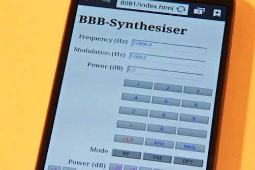

The whole thing is controlled from a web browser.
It is quite small and can fit inside a screened can:

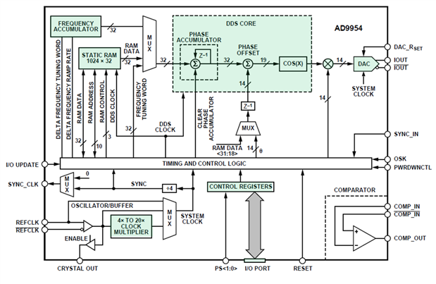

Direct Digital Synthesis (DDS)
The DDS method in summary constructs a sine wave digitally by sending a table of numbers to a digital to analog converter (DAC). The block diagram from the AD9954 datasheet shows how it works. The areas relevant to the following discussion are highlighted in green.
The DDS chip is fed by a high frequency clock (in this case a 100MHz oscillator is multiplied up to 400MHz by the DDS chip).
DDS devices allow a desired frequency to be programmed using an internal register (e.g. programmed via an SPI or other I/O bus). The programmed value is fed into a summing device or counter, known as a phase accumulator. This is just responsible for repeatedly adding the programmed value to the existing sum, on each clock cycle. So, if the desired frequency is a low value then the phase accumulator will increment in low values too (e.g. the accumulator may count 0,1,2,3,4… if the programmed register value was 1). If the desired frequency is higher, then the phase accumulator will increment in larger chunks (e.g. the count may be 0, 5, 10, 15… if the programmed register value is 5).
The phase accumulator loops back to zero once it reaches its maximum. As can be imagined, each possible value that the output of the accumulator can take represents a different point on a sinewave. The block marked COS(X) in the diagram above can be a look-up table to convert from the phase accumulator output to an amplitude on the curve of a sine wave. This then drives a DAC.
With a low programmed value in the ‘desired frequency’ register, each clock cycle gradually steps through the entire sine wave and eventually repeats. With a high programmed value, each clock cycle still steps through the sine wave but by missing out chunks of it so that the wave is completed in fewer clock cycles; this means that the output frequency is higher. The output from the DAC must be externally filtered to remove image components beyond the Nyquist frequency (half the clock rate).
The Direct Digital Synthesis method results in extremely low noise close to the oscillation frequency This noise close to the oscillation frequency is known as phase noise. However, the frequency spectrum view may also reveal frequency components in seemingly random (but actually some is deterministic) locations, known as spurious output; these are due in part because the resolution of the DAC can be low and therefore the constructed sine wave has errors that in the frequency domain show up as spikes of signal at different frequencies than the desired one. These artifacts can be filtered and removed, but filters are expensive and usually non-adjustable so there is a practical limit to what can easily be done to remove the artifacts.
Sometimes a DDS can be used standalone, or it can be used as part of a PLL in a more advanced frequency synthesiser. The DDS can replace the crystal oscillator in a PLL as an example (other topologies are possible too). The combined approaches provide the best of both worlds; it provides the extremely low close-in noise that a DDS exhibits, and greatly reduced spurious content. Today, if there is a need to create a variable frequency oscillator to span a large range, it is likely to be impossible to beat a DDS based system for all-round performance and value. A more high-end design would combine it with a PLL (but a DDS alone can have incredible performance).
Just to continue with the benefits; a typical feature of Direct Digital Synthesis is the capability to control frequency to a very high granularity; with the AD9954, the 32-bit resolution allows granularity to under a Hertz - perfect for fine-tuning radio receivers.
More notes on Direct Digital Synthesis can be found here.

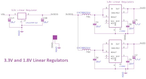

Power Supply
The input to the board can be 5V; it can be directly powered from the BBB header, so no additional external supply is needed (it will consume several hundred mA during operation however). The circuit here shows the power supply circuitry.

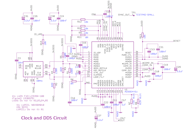

Clock and DDS circuit

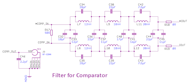

The diagram here shows the main schematic. A few unusual value resistances are required, in places. Most parts were 0603 sized, but the 100pF capacitors were 0402 sized. The DDS circuit is controlled by the digital lines shown at the top of the schematic (SDIO, SCLK, *CS and SDO). Optionally, the OSK, PS0 and PS1 pins are needed if high speed switching of frequencies is needed (e.g. to use as a FSK modem).
The output of the DDS (current, not voltage) is at the IOUT and *IOUT pins at the bottom of the schematic. There is also a built-in comparator (pins shown at the right of the schematic) which is used to convert the sine wave output into a square wave if desired.
An On Semi oscillator was used. There is a alternative part Farnell code indicated in the circuit above but the price looks incorrect for it - another replacement would be Farnell code 2095912). The AD9954 does get warm during operation, but not too hot to worry (if anything the oscillator runs warmer than the AD9954). The board had space to install a PowerPeg (part code TCAP-4325) from TEM Products:

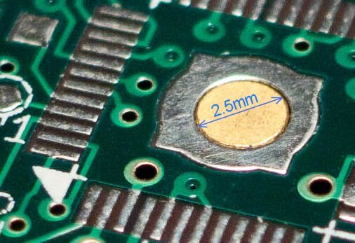

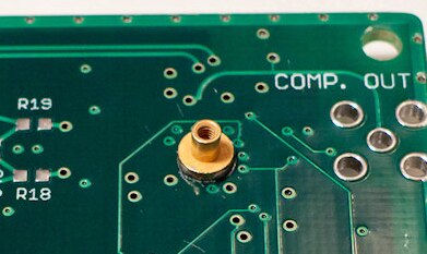

It was hand-soldered in place (there is a procedure), but for this board it was found that the AD9954 does not get hot enough to require it. However it was good to get practice with the PowerPeg because some projects will need the thermal interface capability that it provides. The pegs really are an excellent design. Here is the underside:

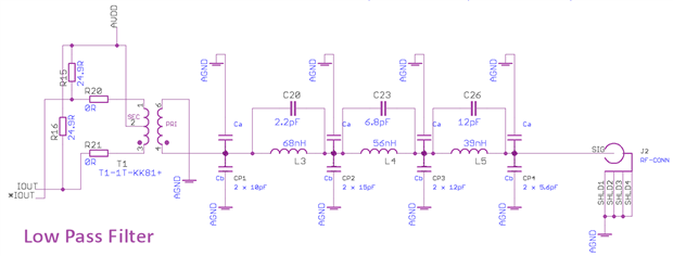

Sine Wave Output
The DAC output is converted from a balanced signal to an unbalanced one using a transformer. The signal is then filtered by a low-pass filter. The inductors need to be RF types, and Coilcraft 1008HQ parts were used in this instance. This part of the board was spread out and kept far away from the clock circuit.
Note that if you’re placing this in a screened can, you will want to use a bulkhead connector for J2, rather than the one in the photographs earlier.

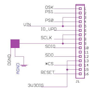

Connections to the BBB
The diagram here shows the connections from the circuit that go to a connector J1. This connector is used to interface to the BBB.
The pins that were connected are shown here:
// DDS board          WireColor            BBB
// 5 - VIN            RED           P9_5    VDD_5V
// 6 - IO_UPD         PURPLE        P8_39
// 7 - GND            BLACK         P9_1    DGND
// 8 - SCLK           ORANGE        P8_40
// 10 - SDIO          YELLOW        P8_41
// 14 - *CS           BLUE          P8_42
// 16 - RESET         WHITE         P8_43

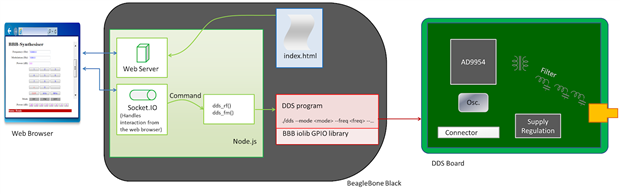

Software
The software is in two halves - C code, and JavaScript code. It is described below, after some preparatory steps.
Preparation
The software is attached to the end of this post. It is straigntforward to use; the file can be unzipped and placed in a folder off the home folder (/home/root in my case). I created a folder called development/dds using this syntax (from the /home/root folder):
mkdir –p development/dds
So, the full path is /home/root/development/dds
In that folder, unzip and place the software. It can be compiled using:
make all
You will also need a socket.io library. It will take a few minutes to install. To do this, in the same folder type:
npm install socket.io
C code
This is in a file called dds.c and it implements a command line capability to control the DDS board. The actual I/O capability is enabled using a software library called iolib described here (it is part of the attached zip file, in files BBBiolib.c and BBBiolib.h).

JavaScript Code
The other half of the software runs on the Node.js platform. The software is contained in a file called index.js and can be run by typing:
node index.js

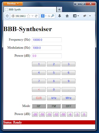

When run, it will sit and wait for any web browser to connect. When it does, it will serve up the index.html file and allow control of the DDS. User interaction via the browser will result in the index.js file automatically executing the dds command line program.
With any browser, type the following:
http://xx.xx.xx.xx:8081/index.html
and you will see this appear:

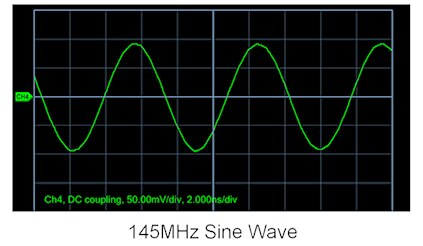

The output was measured to be -8dBm (about 90mV RMS) into a 50 ohm load across most of the frequency range, with a drop of 2-3dB toward 160MHz due to the low pass filter, dropping dramatically after that. If you want to experiment with radio projects, this output level is perfect for the active mixer portion of radio circuits.
The output level was measured using an oscilloscope. Here is an example of a 145MHz signal created by the board:
The screenshot here shows the output of the circuit, programmed to generate a fixed 60MHz signal, observed on a spectrum analyser. The x-axis is 5kHz per division, and the resolution bandwidth is 1kHz. The y-axis is 10dB per division.

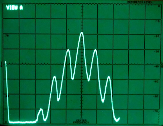

Nowadays spectrum analysers have built-in tools to calculate phase noise, however that capability does not exist in a such an early spectrum analyser. A procedure to calculate it is detailed in an app note but I’m hitting the noise floor; all that is observable is the response of the filter inside the spectrum analyser. The expected result is -110dBc at 10kHz for a 159.5MHz signal according to the AD9954 datasheet. As expected, the DDS provides extremely good results here.
The oscilloscope has a very good FFT capability, and so it was decided to observe the FM spectrum on it. Here is a 25kHz carrier with 1kHz modulation frequency. The vertical axis is 20dB/div, and the x-axis is 5kHz/div:
This corresponds very well to a simulation using the same frequencies:
Here is  another FM signal, this time observed on the spectrum analyser. This is a 60MHz carrier with a 5kHz modulation frequency. The vertical axis is 10dB/div and the x-axis is 5kHz/div and the resolution bandwidth is 1kHz:

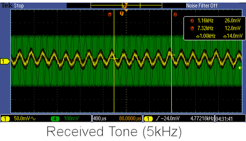

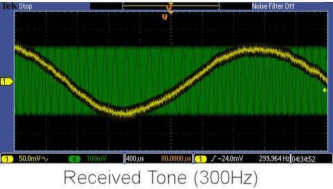

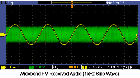

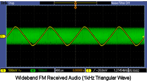

Sometimes it is good to really verify all is well! And ensure that the tone was modulated correctly with the right frequency and no anomalies. So, here is the recovered audio (i.e. I plugged into the audio output) from a radio for a 300Hz modulation frequency:
Here is the same thing but for 1kHz:
It was possible to see the radio receiver’s bandwidth by experimenting with a few more frequencies; this was 5kHz modulation frequency:

    I found that I needed new brighter lights and magnification just to get the ICs assembled - I struggled for a couple of days wondering why the DDS was not working, only to find some pins still loose even though I'd cleaned and then done the 'nudge' test : ) The cleaning brush bristles are too thick to go between the pins on the ICs : )
