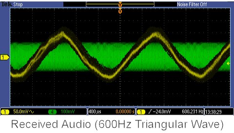

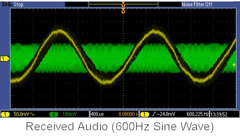

    shabaz over 12 years ago in reply to e14 Contributor
    Hi Joyce,
    I wasn't entirely sure of what you mean, but the signal can be received with any ordinary radio, so a cellphone with an FM receiver would pick it up too. If you mean transmit at cellular frequencies, the frequency range is too low (and there may be legal implications). For a controlled test without broadcast, it would be possible in a few ways, e.g. using a 'RF mixer' would do it. Regarding triangle waves, if you mean a frequency ramp/sweep, this is possible in two ways; either the built-in capability in the AD9954 device can be used (it can be programmed to automatically generate a sweep), or the BBB could be programmed to manually sweep through a range. I plan to implement the latter in the software at some stage, because it would be great to use it for checking the frequency response of circuits (the synthesiser would be set to sweep, and the oscilloscope would be set to a slow timebase so that the x-axis range matches the period of the ramp (and the BBB could generate a trigger for the oscilloscope too).
    If you mean a triangular wave FM modulation tone, that's an interesting question. I replaced line 2 of the code listed in the 'Look-Up Table for FM Modulation' section in the post above with this (taken from here):
    s=(8/(pi()^2)) * ( sin(x) - sin(3*x)*(1/(3^2)) + sin(5*x)*(1/(5^2)) - sin(7*x)*(1/(7^2)) + sin(9*x)*(1/(9^2)) - sin(11*x)*(1/(11^2)) + sin(13*x)*(1/(13^2)) - sin(15*x)*(1/(15^2)) );
    Then, inserting the result (this gives a 101 point result, but just the first 100 results is needed) into the dds.c file and recompiling generated the following waveform at the audio output of the FM receiver (60MHz transmission, 600Hz triangular tone modulation):
    Just for comparison to the sine wave:
    This is not wideband FM (although the AD9954 can do wideband FM, since the principle is the same, the RAM just needs to be populated with contents for a higher modulation) which would improve the result. I should also move to using more of the RAM for more accurate waveforms, since the current code is using less than a tenth of it. In theory any waveform is possible with the device, so depending on the need, it would be possible to even draw the desired waveform, perhaps in the browser, although this is beyond my level of JavaScript experience.
    You mentioned there are a lot of uses for the synthesizer. Have or can it be used to generate triangular waves with a cell phone instead of a radio? I am just learning about this subject.
