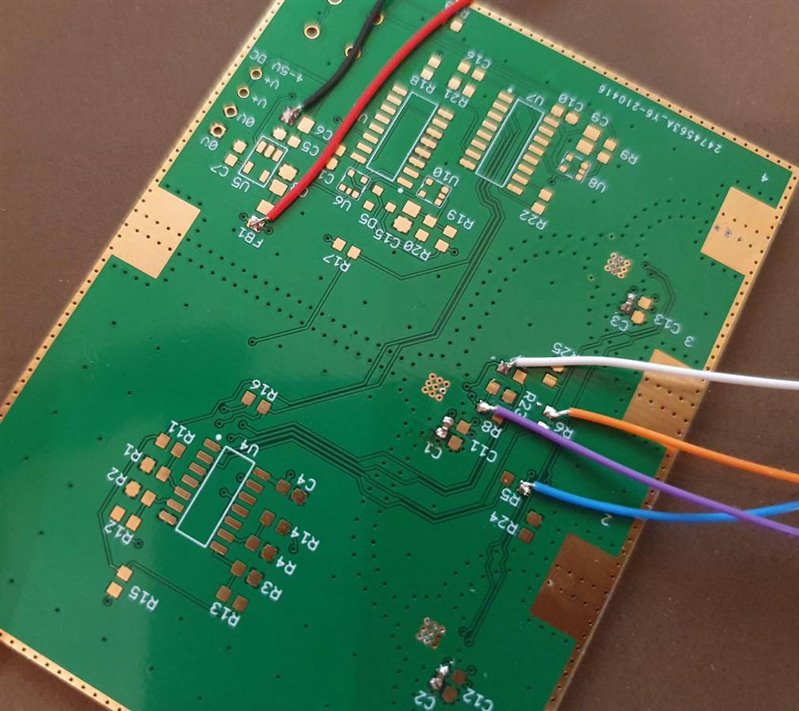

    I made an effort to start the PCBs today, by just attaching the RF switch ICs first. I attempted to make two boards, since I had six of the ICs (each board needs three). The first board visually looks…
    shabaz over 5 years ago +5
    The boards arrived quicker than the components. All parts are in-stock/orderable (just about), but are arriving in several packages, very slowly : ( Definitely issues getting components these days. Not…
    Updated with the final board photos, and measurement of insertion loss. I think it's working reasonably well, at least to start making use of it! I have already used it a bit, and need to document that…
    Getting close! It was the right idea to test the boards before soldering much else. So far, all I've soldered are the RF switches, and the 100nF supply decoupling capacitors for each of them.
    Then I attached wires to the four control pins (labelled CTLA1, CTLA2, CTLB1, CTLB2 in the circuit diagram) and the 3.3V supply and 0V, as shown here.
    Then I patched those wires into a breadboard, supplied the 3.3V power (current limited, the switches only draw tens of microamps), and then just wired the control lines to 0V or 3.3V to observe the switching behaviour. To observe it, I just used a multimeter set to ohms. From the J5 RF connector trace out to any of the other RF connectors traces, the resistance was about 7 ohm for the switched-in path (i.e. about 3.5 ohm resistance per switch IC), and about 45 kohms for the switched-off paths, so it's functioning at some level. There was slight variation between the ICs (e.g. say 4 ohm instead of 3.5 ohm), Incidentally I can imagine if there was lots of $$$ laying around then a whole reel of ICs could be purchased and a test jig could be made to sort them, so that they match per board, before soldering them on.
    Anyway, that was for the good board, but the second board was definitely faulty, the resistances were low. To fix it, I reheated the board, lifted off one of the RF switches with tweezers, applied flux paste to the underside of the chip and re-placed it in position, and then gently tapped on top of the part to hope that all the pins of the IC were making contact. Then repeated for the next switch and so on. This whole exercise must have taken at least 15-20 minutes or so, but the chips survived the heat during that entire duration, because I'd used low-temp solder paste - the first time I've tried such solder with a stencil. I really like it, it seems great for people like me who don't do such parts regularly enough to be totally comfortable working quickly. It took me ages to nudge the parts just right, I kept over-nudging it. I didn't see the self-adjustment that is supposed to happen by capillary action, it must have been so slight it wasn't visible.
    The particular solder I used was a 30cc syringe of Qualitek 670 (tin bismuth, Sn42/Bi58) which costs £25+tax and was purchased two years ago and not kept in a 'fridge. Surprised it all worked out so far.
    My only slight concern is that maybe the flux on the second board wasn't totally used up under the ICs, it may affect performance (it was no-clean flux, but I didn't have good control or measurement of temperature, my pre-heater is very basic.

    jc2048 over 5 years ago in reply to shabaz
    Interesting board and project. The board looks very impressive with all that gold plating and the curved tracks.
    Could it be that with the 47k measurement you aren't measuring the switch isolation resistance? The RF input abs max range is only +/- 300mV [the datasheet doesn't explain why - it might just be a dissipation limit, but it could, alternatively, be some sort of protection network coming into play or maybe parasitic diodes starting to conduct]. My old Fluke bench meter drops 400mV across a 47k resistor if I let it autorange. Your meter might simply be finding a path around the 'off' switch that you wouldn't see in normal operation.
  • jc2048
    shabaz over 5 years ago in reply to jc2048
    Hi Jon,
    Thanks!
    That's a good point, that perhaps I'm measuring something else like a path through diodes. Hopefully by the weekend I can complete a board and try some more thorough tests.

    geralds over 5 years ago in reply to shabaz
    Hi shabaz ,
    I once spoke to a circuit board manufacturer (I was with him to discuss a technical matter and as I walked through the production hall I saw that the RF boards (cell phones) were all without gold plating), I asked him why all of them these circuit boards have no gold plating.
    The reason is the Seebeck effect, i.e. the thermal effect, which namely generates an elementary voltage between the conductor track layers.
    https://en.wikipedia.org/wiki/Thermoelectric_effect
    If you look at the elementary voltages of the thermocouples, these can amount to 300mV for certain combined elements.
    Copper, nickel and other coating elements, gold, tin-bismuth, etc. on the board ... the pins (plus the parasitic elements in the components around these pins) of the components.
    Maybe it's a point on your board.
    Best regards
    Gerald

    Hi Gerald,
    For (cheap) prototypes there's unfortunately no choice, since for those there is only ENIG or HASL as options, and HASL would likely be worse for controlled impedance for such traces, and I wanted the flat surface for the QFN parts. As I understand, ENIG would never be used in production since it has other problems (certain defects can't be detected causing problems later). Unfortunately I don't know other than a few basics how processes differ for high frequency boards, but as you suggest, for sure there will be important detail, that is a very unknown area for me currently. I need to get back to this board, I purchased an ultra-fine tip for the RF connectors, a 1mm tip just does not fit : )
