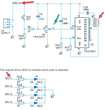

There was an issue which needs a few bodge wires; it was found that the power on/off feature was not working, and the rev 1.0 board was permanently powered. To fix it, the following three changes were made (these changes are incorporated in the rev 1.1 board files):
(a) Rotate C16 to isolate one end of it, and solder that to +3V3 at ferrite FB1
(b) Lif pins 14 and 16 of U7, and wire the pins to +3V3 at ferrite FB1 too
(c) Lift pin 13 of U7, and solder a 470k resistor to the lifted pin, and the other end of the resistor is attached to U8 output pin.
The three changes result in the circuit diagram being modified as shown with the red arrows here:

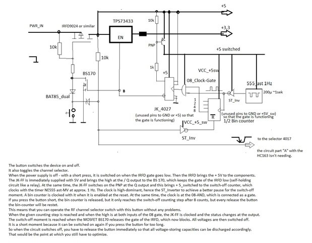

    * the one thing that definitely doesn't currently work, and not sure why, is the power on/off feature. (If anyone can spot any flaw in that portion of the circuit, it would be most appreciated). There is a single button to cycle between the four electronic switching positions, but a long press was supposed to toggle power on or power off the device. However, it seems to be permanently powered on and I can't switch it off. I've not probed it to see if the regulator enable line is toggling as it should.
    It is minor I guess, I could wire in a slide switch, but I do want to make it work.
  • geralds
    geralds over 5 years ago in reply to shabaz
    Hi shabaz ,
    I created by the fast a switching-on/off circuit. May be it helps. I didn't testing yet, I just drawn it as an idea.
    Sure, something have to be optimizing.
    I hope it helps. It is just an idea. I tried to minimize the number of the components.
    Unused gates, pins must be terminated to GND or to its pwr_source so that they are work correctly.
    The first point, what I have realized, was that you have connected directly the PWR_IN to the components without any power switch.
    The other is that the "self-hold" switch with hold/release was not given.
    Please tell me if I am wrong. The (bypass) capacitors are a big point here that the circuit needs to be rearranged.
    Best Regards
    Gerald
    shabaz over 5 years ago in reply to geralds
    Hi Gerald,
    Thank you for this!
    I've been working late and didn't get a chance to update earlier, but I think I know what the issue is with the current implementation, it was quite a silly mistake, but will mean several wires and a resistor may be needed to resolve it on the current PCB : (
    The problem is this:
    The red arrows below show that the LEDs are actually controlled by the permanent supply called PWR_IN. This means even when the switched supply is off, the LED stays lit and the button continues to allow the LED to be cycled : ( Basically I need to operate that U7 from the switched 3.3V supply, and not from the PWR_IN supply. The green arrow wire is used to control power on/off, so that U8 inverter must still be operated from the permanent PWR_IN supply, so I need to lift pin 13 of U7 and wire in a resistor, since 5V logic will be controlling the 3.3V U7, after I modify that to operate from the switched 3.3V. I will make the changes and test that tomorrow.
    I like your idea, and yours has lower standby current. It's definitely the better way to do it with the MOSFETs and diode OR'ing. Clever idea to clock it for the long switch press determination, I would not have thought of that.
    If the current consumption is ok-ish, then I'll run everything from a Lithium primary battery (just over 6V, which is slightly out of spec but I think it should be fine), otherwise if the standby current is too high then for now I will add in a slide switch, since it's too expensive a board to waste now it has the components on it.
    I will write it up tomorrow and take some photos.
    Thanks again for looking through it, and working out the nice switching mechanism!

  • geralds
    My pleasure!
    Yes, I saw that..
    Be careful with the 6Volt. Some of the 74HC xxx types could be destroyed above 5.5V. Abs.Max is really Abs.Max.
    A 5V LDO, eg. Microchip Micrel device (a type that is continuous in the event of undervoltage) could help, So than you can use a 9V block battery / accu.
    A serial protection diode in front of the MOSFET switch (in front of the R_Junction to the gate) can help against polarity reversal.
    The 74HC4017 does not really have to be debounced when using Schmitt triggers at the input. It's a cozy gate.
    The automatic switch-off can easily be knitted together on a proto-board, just to test it out.
    It is logically smooth.
    Only the dynamic conditions of the block capacitors could play a role in that they still supply a gate during the switch-off process, or if a return current flows in to create a metastable situation. That just has to be prevented.
    It's a large flip-flop gate with multiple components. I think it works stably.
