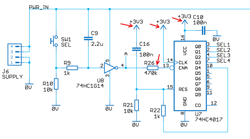

Switch Selection
The circuit below shows how the four poles of the switch are selected. From the left, a push-button is debounced using a charging/discharging capacitor C9, and this is cleaned up into a logic signal using a Schmitt trigger input inverter, U8. The point labeled A at the output of the inverter is used later on, see further below.
The input to the counter looks unusual in that it is fed to the Enable pin of the counter IC U7, but that's because the 74HC4017 can accept a clock at either pin 13 or 14, and by doing it this way, I can invert the clocking so that the count changes when the button is pressed, rather than when the button is released.
The 74HC4017 is a round-robin type of counter (Johnson counter) and it will cycle SEL1 to SEL4 outputs high, one at a time. Pin 10 is used to reset the count; C16 and R21 are an attempt to reset the counter when the supply is initially attached.
The outputs drive LEDs to indicate which pole is selected.

Power On/Off Circuitry
The switch-pole selection push-button also serves to power up/down the rest of the circuit, using the Enable pin on the regulator that was marked B.
In the circuit below, from the left, point A comes from the Schmitt trigger that was attached to the button. If point A is high, then D5 rapidly charges capacitor C15, but if point A is low then resistor R19 slowly discharges it. When the button is held down, point A is low and after a relatively long time (just under a second) the output from inverter U10 will go high and clock the counter IC U9. This IC is being under-used; it's just operating as a divide-by-2 circuit, to provide a toggling action on pin 14, which is connected to point B, which goes to the Enable input to the regulator. Thus, holding down the button will cause the power to switch off or on. Short presses will not allow C15 to discharge fully, and therefore the power status will remain unchanged while the short button presses are being used to control the RF switch poles.
The inverter U6 is redundant, you could just wire the *CLR pin of U9 directly to the supply rail. My original circuit was intended to require a reset mechanism and collapse the 74HC4017 function into a single IC, but I gave up on that, and accidentally left U6 in the circuit. These single gate ICs are cheap; in comparison, each of the RF switch ICs being used costs tenfold, and each of the RF connectors is twentyfold, so I wasn't very motivated to correct the inverter! and so I didn't make changes to the PCB design.

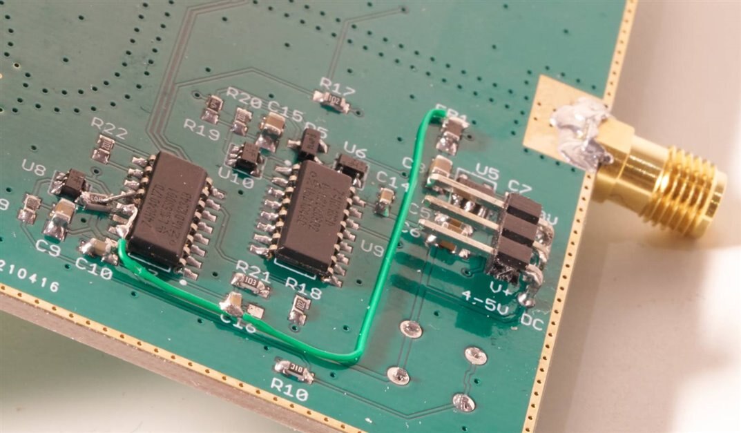

There was an issue which needs a few bodge wires; it was found that the power on/off feature was not working, and the rev 1.0 board was permanently powered. To fix it, the following three changes were made (these changes are incorporated in the rev 1.1 board files):
(a) Rotate C16 to isolate one end of it, and solder that to +3V3 at ferrite FB1
(b) Lif pins 14 and 16 of U7, and wire the pins to +3V3 at ferrite FB1 too
(c) Lift pin 13 of U7, and solder a 470k resistor to the lifted pin, and the other end of the resistor is attached to U8 output pin.
The three changes result in the circuit diagram being modified as shown with the red arrows here:
Here is how it looks on the rev 1.0 circuit board:

    shabaz over 5 years ago
    Here's the modification to get the power on/off function working with the current circuit:
    Such an approach can be implemented on the current PCB (rev 1.0 board) by performing the following steps (as shown in the photo below):
    This is still ugly, but at least allows for this revision of the board to now fully function.

    geralds over 5 years ago in reply to shabaz
    My pleasure!
    Yes, I saw that..
    Be careful with the 6Volt. Some of the 74HC xxx types could be destroyed above 5.5V. Abs.Max is really Abs.Max.
    A 5V LDO, eg. Microchip Micrel device (a type that is continuous in the event of undervoltage) could help, So than you can use a 9V block battery / accu.
    A serial protection diode in front of the MOSFET switch (in front of the R_Junction to the gate) can help against polarity reversal.
    The 74HC4017 does not really have to be debounced when using Schmitt triggers at the input. It's a cozy gate.
    The automatic switch-off can easily be knitted together on a proto-board, just to test it out.
    It is logically smooth.
    Only the dynamic conditions of the block capacitors could play a role in that they still supply a gate during the switch-off process, or if a return current flows in to create a metastable situation. That just has to be prevented.
    It's a large flip-flop gate with multiple components. I think it works stably.
