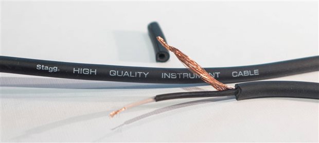

What is wrong with Off-The-Shelf?
The cable I inspected did not have great shielding (proven through tests – see later) consisting of wire strands providing perhaps 30% (this is a guess) of coverage of the centre conductor.
In its favour, the cable outer insulation was very thick and maybe could withstand rough handling as long as the rough handling was no-where near the connectors.
Furthermore it was a very low cost cable and probably would be adequate in a non-electrically-noisy environment. The connections would probably be fine if the cable was not mishandled.

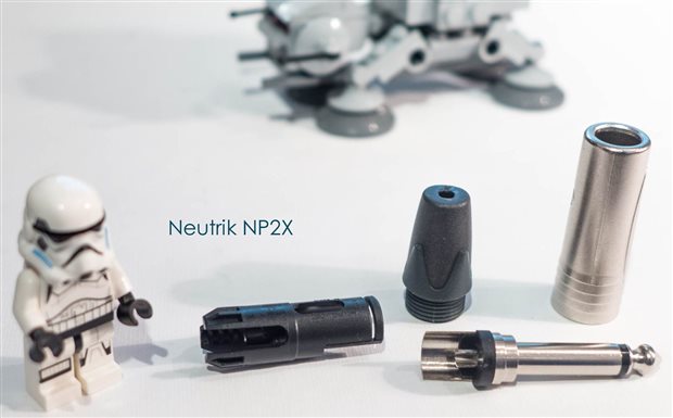

Neutrik connectors are considered good and reliable, so I made it a priority to try out some of these.
I did not go for the most expensive one but instead picked a model that is mentioned on various Internet forums; the NP2XNP2X. I wasn’t entirely happy with it but it’s definitely a very good product – I suspect this particular model is also popular because it provides lots of space for soldering. It had a trough-like shape for soldering the centre connection, and just a curved surface for soldering the screen. Another point is the slightly unusual shell found on Neutrik connectors. The large metal shell actually fits from the ‘business’ end of the connector, not the solder terminal side. The smaller plastic threaded part is pushed over the cable before soldering the connections. The cable clamp was achieved by a separate plastic piece. It was quite a novel attachment and it may be quite effective. I just didn’t like that nothing is secure until the final part of the assembly is screwed. Up till that point, the wires are not secured (solder alone is not really secure). Still, I can see why this is a popular connector.

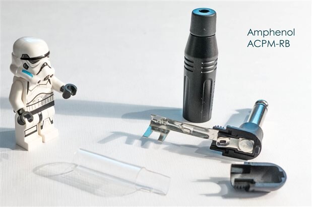

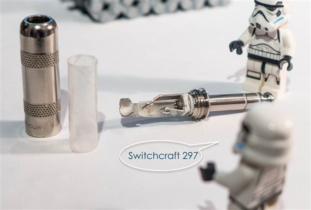

Next, I examined an Amphenol right-angle connector part number ACPM-RB Amphenol right-angle connector part number ACPM-RB. It has a multi-part metal shell. Once the curved cap is placed on the right angle part of the connector, the back shell can then be screwed on and it will secure the curved cap. It was also great that it had solder terminals with holes; the sleeve terminal has a partially knocked-out hole, leaving a hook. The integrated cable clamp has three prongs which seems like a good idea. A plastic sleeve is also supplied to help with preventing shorts to the metal shell. Finally the metal backshell also has a small piece of plastic strain relief to keep the wire straight for a short distance beyond the metal shell. Overall, it is a very high quality part.
However my favourite was one by Switchcraft, model 297Switchcraft, model 297. It had the integrated cable clamp, solder terminals with holes, and an integrated insulator to protect against shorts from the tip or ring wires to the sleeve. There was no hole for the sleeve terminal and because of the integrated insulator the sleeve wire would have to be folded over and soldered on the other side.  It has many other great features however. All of the solder terminals are bent in an angle such that there is adequate room for bringing the wires from the outer side. The construction of the plug uses some type of glass fibre for acting as an insulator unlike plastic seen on other connectors. The solder terminals are nickel-silver electro-tinned for great ease of soldering. Furthermore the metal used for the solder terminals  and integrated cable clamp is thicker than some other connectors had. There is no plastic strain relief but this doesn’t matter when built into a complete cable assembly (see later).

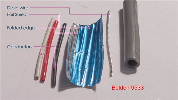

In order to have results I can use in future, I tried to only use easily available cables with a known part number. Cable is expensive (copper is expensive) so I wanted to standardise on just a few types of cables that would be useful for audio and non-audio applications. The cables that were selected were Belden 9533Belden 9533 and Belden 9841NHBelden 9841NH.

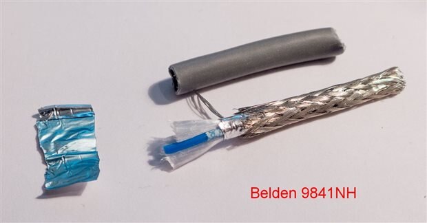

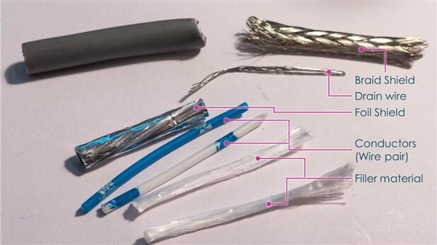

The Belden 9533Belden 9533 is a 4.1mm thin cable with three cores and a foil shield with an associated bare wire (called a drain wire) and is primarily intended for RS-232 use. The 9841NH9841NH has two cores and a braid and foil shield. It is thicker (5.9mm) and physically tougher. It is overkill for home audio applications but I liked it because it could also be used for non-audio applications. It is primarily intended for RS-485 signalling.
It should be noted that these cables are actually even better constructed than their datasheet description : ) The 9533 cable is not a controlled impedance cable but nevertheless the three conductors are tightly held together in a consistent intimate configuration in their foil shield as seen below. Also the foil shield is nicely folded on the outer edge for very effective 100% coverage.
The 9841NH 9841NH also has a similar folded foil shield but it is also covered with a 90% coverage braid surrounding the foil shield making the cable better screened at lower frequencies and providing physical resiliency.
Also the 9841NH does have a controlled impedance pair of wires and filler material is used to keep the wires in formation. We don’t actually care about the impedance, but we care that the two wires are consistently intimate with a twist, so that any noise signal that is picked up will be common; it will therefore be eliminated in a balanced audio configuration. The 9841NH would be superb for balanced audio applications as a result.
In summary it is very interesting that both of these cables should perform very well yet are low cost and available in single metre lengths if desired; no need to buy a huge roll!

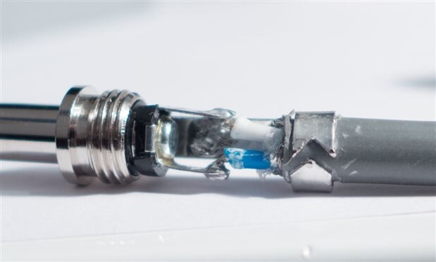

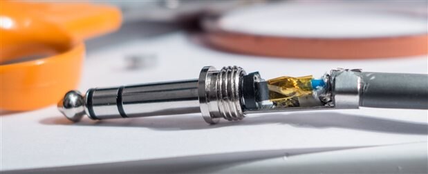

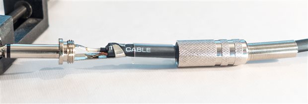

Engineering practice dictates that solder alone should not secure a connection, wire breaks should not short against other pins, the cable should be clamped and cable strain relief should be provided to allow the cable to flex without strain near a connector. One particular difficulty is holding the connector and wire together while soldering. Some websites incorrectly state that it is ok to add solder to the connector and wire separately and then re-melt solder on the connector and then add the wire while the solder is molten in an attempt to make it easier to form the join.
A clamp can solve the problem. Any clamp with soft inserts (e.g. pieces of wood) could be used. The one below is all aluminium and has a V-shaped groove so the part doesn’t move too much.

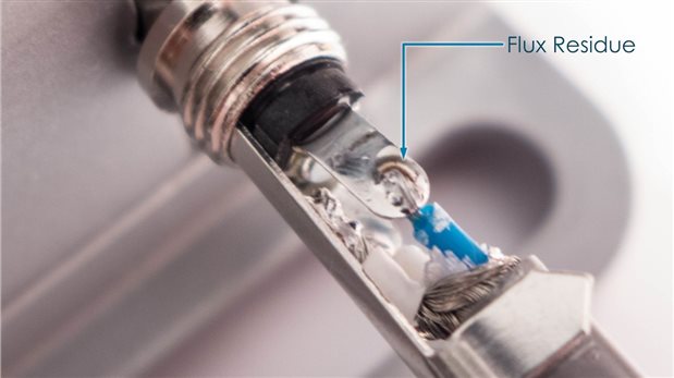

Another issue is that the solder might not ‘stick’ to the large metal terminals. The solution is to use a high-power soldering iron and a large bit (3mm or slightly more) to get heat to the join. A small bit of flux paste will result in an excellent join. The photos below show an example walk-though assembling an audio cable. Don’t forget to pass the connector backshell onto the cable first.

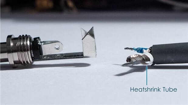

When the braid shield needs soldering there is always the problem of how to deal with the pigtail. One nice method is to use solder sleeves but there is not enough room to use them in a typical audio connector. Instead it is easiest to use a small piece of heatshrink tubing to insulate a small portion of it. Twist the braid into shape, place the heatshrink tube into position and then tin the end; the tube will shrink due to the conducted heat. The aim is to just tin the end of the pigtail, not the entire length.
Similarly any other wires should be just very lightly tinned; no more. Once the wires are inserted through the holes they can be folded back and then a small bit of flux pasteflux paste applied before soldering.
The join is complete when the solder fills the hole entirely and the entire wire end is covered with solder and has a fillet all around the side that was soldered.
With fresh clean connectors it is best to use No-Clean fluxNo-Clean flux. It will leave a residue but it can be ignored or (if you prefer) wiped off (using flux remover and a brush or cleaning wipe) as shown here:

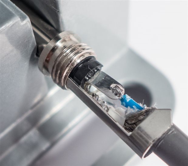

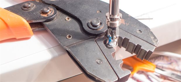

I don’t have a specialist tool for the cable clamp but a low-cost crimp terminal toollow-cost crimp terminal tool will probably work very well. Note that ideally you want the plastic outer insulation to extend one half the diameter of the cable from the end of the clamp if possible with the specific connector in question; it is not always easy with your first connector especially since they are so space constrained and mine is a little low here.
By opening and closing the jaws of the crimp tool and rotating the assembly it is possible to get a neat clamp all around.

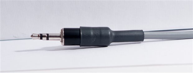

Heatshrink tube can be used as insulation where possible, but audio connectors do not have a lot of space. An alternative option could be to use Kapton tape Kapton tape (use a pair of tweezers to pull it through) wrapped around individual conductors. It is very thin so will fit in a tight space, and it won’t leak a sticky residue.
The end result will allow the connector backshell to screw on comfortably. At this point there should be a lot of confidence that the wires will not have broken during the backshell assembly (due to the cable clamp securing the heavy cable successfully) nor shorted anywhere. However it should be verified immediately with a multimeter.
Next some heatshrink tubing (16mm16mm and 12mm12mm are useful; these particular ones are adhesive lined and have 4:1 shrink ratio) can be placed around a portion of the connector backshell and the cable. 4:1 ratio tubing is really ideal for this. Adhesive lined is excellent. It can be purchased in short lengths good for at least 10 complete cable assemblies so it is not expensive. Start at one end (the connector shell end) and make sure that it shrinks evenly toward the cable end, but briefly stop before it touches the cable. Let it cool a bit, partially unscrew the connector backshell, squeeze a bit of thread lock adhesivethread lock adhesive and then tighten the backshell. Then finish the heatshrinking and then retest. The end result will be very rugged and should provide years of good service. For repair the end can be snipped off, the heatshrink cut off, and the threadlock is semi-permanent; it can be disassembled with force.

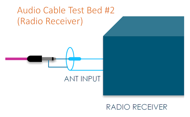

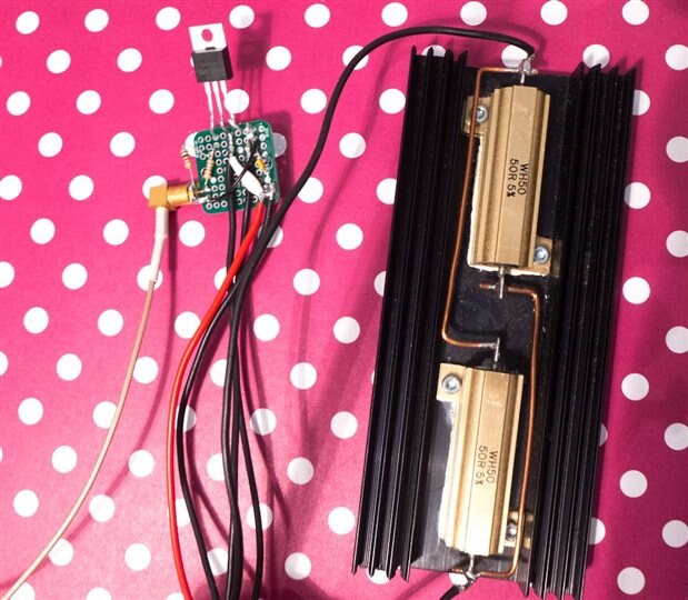

Some basic tests are obvious; the usual tests for shorts and intermittent connections can be done with a multimeter. I also wanted to check how effective the cable was at shielding from unwanted signals however. There are different ways that unwanted signals can be picked up. Capacitive coupling can occur if the cable is very close to another cable for example. Another source can be whenever there is changing flux nearby, i.e. inductively coupled noise. Radio signals may also be picked up; these should be inaudible but there is a possibility that mixing or demodulation may inadvertently occur in the attached electronic equipment. One test method would be to deliberately have a noise source nearby and see how much is picked up by the test cable. I decided to generate a square wave type of signal at high current and place it close to the test cable. I used an IRFZ44 MOSFETIRFZ44 MOSFET and a 48V DC supply; the load was a 25 ohm resistor (two 50 ohm, power resistors in parallel) so that almost 2A was being switched. I didn’t have an alternative power MOSFET handy, so I have to be careful not to exceed the safe operating area (SOA) of the MOSFET. The heart of it is shown below. The source signal into the MOSFET was an 8V 500usec pulse every 10msec; this would result in a 100Hz tone along with harmonics.
The circuit was just quickly hacked together as a test - it wasn't pretty but it functioned. Note that at this level of power (close to 100W) you do want to make sure nothing accidentally shorts. I have a habit to place new experiments inside a translucent box the first time they are powered up, if they are high powered circuits. I don't want something accidentally bursting uncontained.
I coupled the test cable with a few twists over 10cm or so as a quick experiment. With the off-the-shelf cable I could hear a very loud 100Hz sound through the amplifier and speaker. I then swapped out the cable for the cable I had assembled and repeated the test – no 100Hz sound was audible with the ear right against the speaker.
This experiment could be refined with a higher frequency and spectrum analyzer however for the initial tests I wanted to use easily available test equipment. The simple test was enough to validate that home-made cable assemblies could vastly out-perform some commercial cable assemblies. Sticking with simplicity another far better way to test this is to use a radio receiver. It is one of the cheapest yet most sensitive devices in a lab. It can detect femto-watts (10^-15 W) of signal power. As a rough analogy of power ratios consider listening to a pair of headphones 20 km away from your ears image
Note that most radio receivers will not pick up RF signals so low in frequency, but there are plenty of harmonics that could be received. I upped the pulse rate to 1 every millisecond (and shortened it to 100usec). With the cable connected to the radio I could easily hear a harmonic with the radio tuned to 20kHz with the commercial cable. Loud and clear! I swapped to the home-made cable and there was no signal received (just radio background noise). This is a convincing result that the shielding is exceedingly effective even at these relatively low frequencies.
