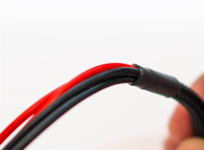

The red red and black wiresblack wires had silicone insulation for flexibility. The wire is 5 metres long; I only used one metre, so there is plenty left over to make various other test leads too.
Since 4 wires will tangle on the desk, plastic braidplastic braid could be an option. It does reduce the flexibility a bit, but not much. I decided to run with it. Adhesive lined heat shrink tubingAdhesive lined heat shrink tubing was applied to stop it fraying. To get the braid over the wires easily, I taped the wires at 15-cm spacing, and removed the tape when the braid was pushed close to it.
The braid could melt while using the heat-shrink tubing, so I protected it with some paper tape (or use Kapton tape) while applying the heat gun, and it worked fine.

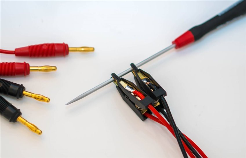

The clips come with screw terminals, but it felt awkward putting the stranded wire inside there. I did consider using a ring terminal, but in the end it seemed it could be easier to just solder the wires. The plastic clips didn’t feel too soft, so I felt they could take the temporary heat from a soldering iron.
The screws play a structural role with these clips though. Without them, the metal portion of the clips slide around. With hindsight, I would have replaced them with 3mm grub screws, but in my case, I just left the supplied screws in there, and it means the wire insulation has to pass over the screw head. It is not a big deal, and provides some grippy area to hold the clips actually!
Since the clips are gold-plated, they are very easy to solder onto. I used a 3mm soldering iron bit and turned up the heat to 350 degrees C, since the aim was to get the heat quickly onto the clip, and finish the soldering task in 5-10 seconds if possible, to reduce the risk of damaging the plastic. It worked fine. Three hands are needed though. I used a flat blade screwdriver to gently press the wire strands against the clip while I soldered it.
