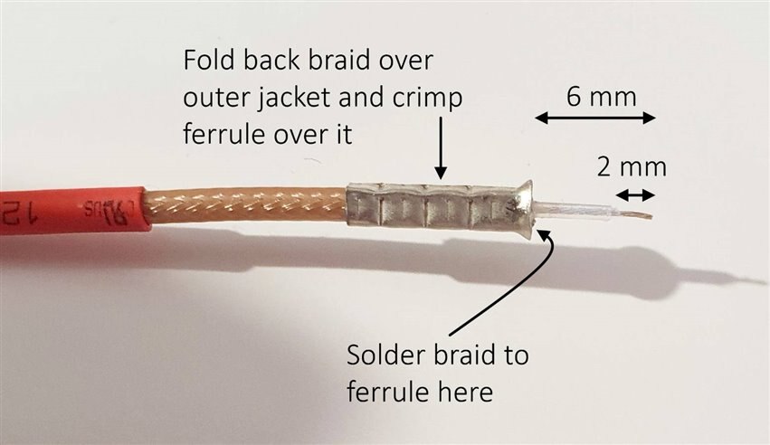

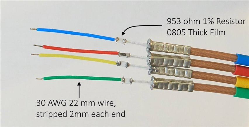

Construction can be very straightforward. Any 50 ohm coax cable can be used. Attach a BNC connector to one end. If you don't feel comfortable doing that, it is possible to purchase BNC-to-BNC cables and cut in half, or chop off one end.
For the resistor, a 1% tolerance 953 ohm thick film (not thin-film) resistor can be used, or perhaps a 5% tolerance 1 kohm resistor (many could be purchased, and individually measured to select the ones closest to 950 ohm).

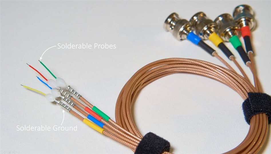

For my implementation, I used RG-178 coax. If you’re unfamiliar with it, it’s one of the most useful coax types for electronics labs as general-purpose hookup-coax, because it is so easy to work with, and excellent for short connections.  It is thin (1.8 mm overall diameter) and the outer insulator is easily removed by lightly scoring with a knife, bending the coax slightly to tear at the score, and then gripping with wire cutters and sliding it off. Another excellent property is that it’s almost impossible to melt the inner insulator (dielectric) when soldering.
I wanted to make several of these probes, so I used heat-shrink tubing at each end for color-coding. I used 2.5 mm2 ferrules to terminate the outer braid, however, it’s not necessary; you could just spin the braid around the outer insulation and tin it with solder to form a circular termination, all ready for attaching a ground cable. Since the coax is so thin, the outer termination could also be directly soldered to the nearest ground point or ground plane on the circuit board under test.
The diagram below contains measurements in case anyone wants to assemble it in a similar way, to get comparable results as I got. I'm not saying my method was good or bad; it's just one data point, so experimentation could improve the results further.
I used an 0805-sized 953 ohm thick film resistor, and fairly thin 30AWG stranded PTFE-insulated wire. This will allow me to solder the probes even in fairly dense locations on a PCB.

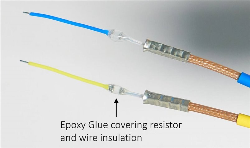

The resistor and the connections to it were covered in ‘instant’ epoxy glue (it sets in a minute or two), and I tried to get glue over the insulation of the wire too, to secure it all properly. Maybe this step isn’t required.

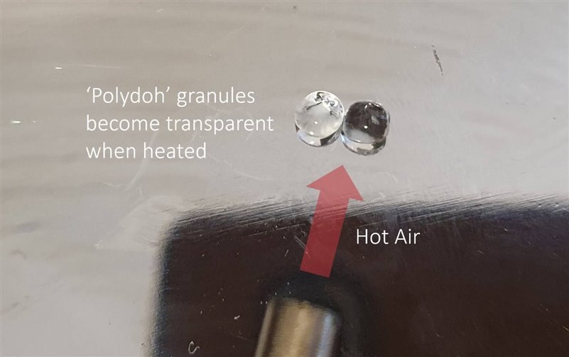

Next, to make the colored plastic blobs, Polydoh was used. If you’ve not used it before, it is like a manual version of 3D printing plastic; it melts at a low temperature and can be formed with ease. It comes as a bag of white granules/pellets and can be purchased bundled with pigment granules too, to be mixed in. It is really cheap – about $15 for a bag containing thousands of granules.
Ordinarily, the granules are supposed to be used with boiling water, but I didn’t want to get my resistor wet, so an alternative procedure was used. I took two granules and placed them on a surface (I used a metal block) and heated it with a hot air tool. After a few seconds, it was possible to place the wire and resistor between the two granules and fold it all around into a kind of pod or egg-shape, using bare fingers (it doesn’t burn the fingers, just feels slightly hot briefly). If it hardens too soon before it is fully shaped, then it can be re-heated with the hot air tool.
If you don’t want white blobs and want to color-co-ordinate with the ‘scope channel colors, then instead of just heating two granules, add a single pigment granule too, and then mash the molten color into the molten granules with fingers, and then (because it will have cooled and solidified) place back on the block and re-heat, and then wrap it around the resistor and form the blob. It’s really easy!

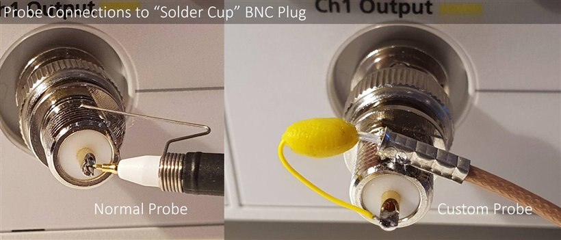

To use the resistive probe, if your oscilloscope has a 50 ohm termination setting, that needs to be enabled. Otherwise, a 50 ohm terminator and a BNC T-piece is required for each probe. This is mandatory.
Next, set the oscilloscope scaling to 20X. If the oscilloscope does not support such a setting, then the scaling will need to be done mentally because the displayed voltage levels will be scaled down by that factor.
Solder on the probe to the circuit under test, attach the probe to the ‘scope and power up the circuit under test!

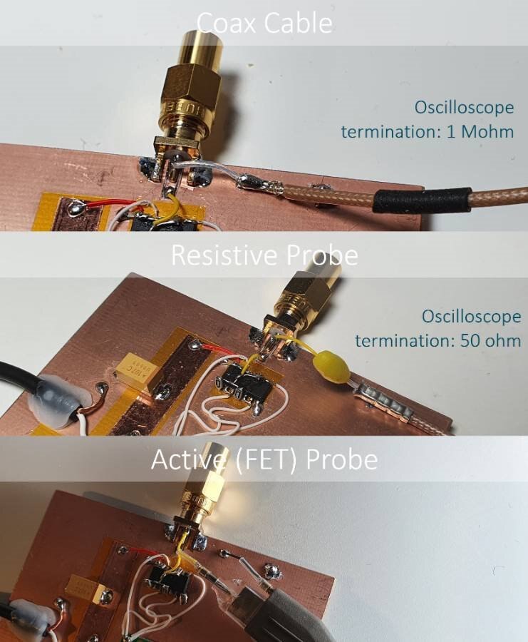

I tested three different probing methods:

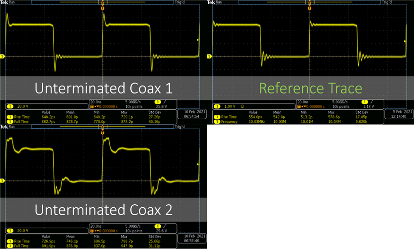

  1. Simple plain coax connected to the square wave generator, and the oscilloscope set to its normal 1 Mohm setting. This will be a bad method as will be visible in the ‘scope traces.

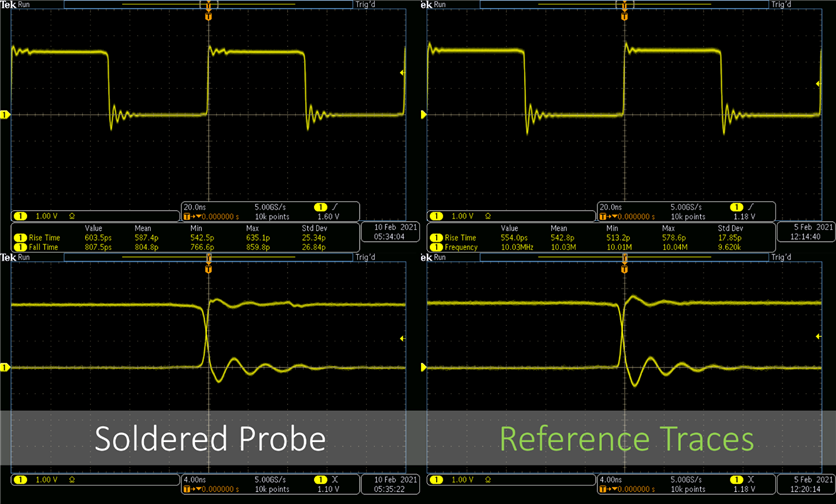

  2. The home-made resistive probe, connected to the oscilloscope set to 50 ohm input

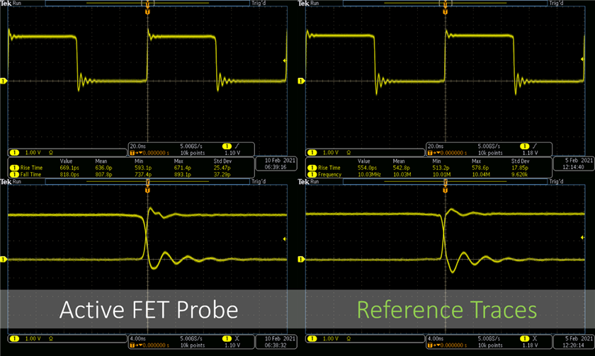

  3. Active FET probe. This probe should give good results but is a pricey option. It will be good to compare the results.
The photos below show the three different methods. For all three methods, the square wave generator output was directed into a 50 ohm load, which can be seen screwed onto the SMA connector at the top of each photo.
The oscilloscope traces below show the results for each of the probing methods. The reference trace (from the square wave generator blog post) is shown on the right for easy comparison. The coax method was, as expected, bad. Coax 1 and Coax 2 were attempts with different lengths of coax, and it made a difference, again as expected. In summary, both Coax 1 and Coax 2 look bad, with Coax 2 happening to look extremely bad. This is the danger of just using coax like this; the result can look extremely distorted.
The resistive probe results are shown below. There is a small anomaly visible about 8 nanoseconds from the time of the rising edge, but aside from that the result looks fairly similar.
The result from the active probe is shown below. There are a couple of small differences here and there, but generally the trace looks similar to the reference.
