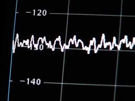

  6. Both instruments have good noise floors.  In this live test case the noise floor on the Tektronix was slightly better that on the Keysight, but the Keysight surpassed the Tektronix when the built in preamp was activated.  Both instruments were set to average 16 traces.  The photos below show the noise floor on the Keysight with and without the preamp turned on.
N9322C noise floor WITHOUT preamp - about -125 dB
N9322C noise floor WITH preamp - about -132 dB
Compare these with the photo below which shows the noise floor on the Tektronix.
MDO4104-3 noise floor - just shy of -130 dB
