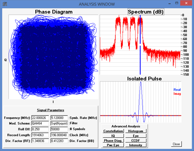

Scouring the web I came across the very nice and small piece of software that promissed to do exactly what I needed. It is called ArbIQ, developed by the very man who wrote excellent paper "Complex modulation generation with low cost arbitrary waveform generators", Mr. Joan Mercade from company "Arbitrary resources" in Spain. There is a trial version available for download, however it is limited and unable to transfer waveform to generator or to save it. If  you want to try it, here is the link: Arbitrary Resources, S.L.

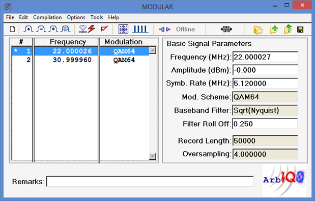

I contacted Mr. Mercade via email and asked him if he would be willing to make 2 files for me using his software, both using 64 QAM modulation, with 2 and 4 carriers, and with PRBS payload data. I was very pleasantly suprised when the email came few day later with generated files and detailed explanation.
So here is what I got, this is the first file with 2 carriers, at 22 and 31 MHz, 5120 ksym/s symbol rate, alpha factor of 0.25 and raised cosine (Nyguist) filter applied.

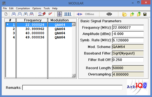

And also the 4 carrier version, 22-31-40-49 MHz, all other parameters the same.
Mr. Mercade also provided detailed description of the generated signals:

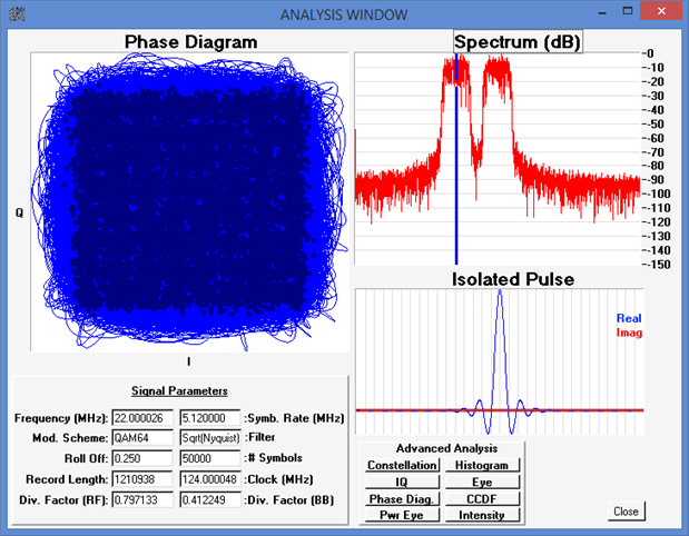

"Each signal have different sampling rate (the Clock parameter) and record length, although they carry the same number of symbols, 50,000. Waveforms are compiled in such a way that there should not be any wrap-around issue and the symbol rate is kept. In order to fulfil these requirements and keep the number of samples as an integer, the carrier frequencies have been slightly adjusted within a few Hz.
This error could be reduced by carefully selecting the record length parameter or just by calculating a signal with more symbols in it, but I think that the error is quite acceptable (and predictable).
The constellation you see is for one carrier and before applying the matched filter at the receiver, so it looks noisy because of the intersymbolic interference produced by the sqrt(raised cosine) filter as required by the DVB-C standard. Modulation quality should be perfect, though, after applying the signal to a DVB compliant receiver.
All the carriers use the same data sequence (PRBS) but I have chosen to incrementally delay the data for each carrier. The phase of the carriers itself has been randomized to avoid that all the signals reach their peak at the same moment in time. The overall Crest Factor is reduced and the signal behaves more realistically while the power and linearity are optimized. "
