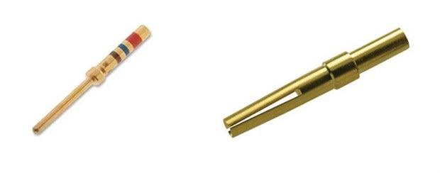

A slightly more uncommon tool for hobbyists, but very common for industrial, military, automotive and aerospace purposes, is the pin crimping tool. It is used with circular pins, and indenters push into the pin from multiple sides. It is a bit like a ferrule crimping tool, but for smaller pins that may be used in connectors such as DEUTSCH, D-Sub and circular connectors with often dozens of pins, and for the center pin for some coaxial connectors. Often I have to use the solder bucket versions, or try to solder as best as I can, but a crimp tool would make life easier, and produce a reliable result.
(Image source: Farnell website)image

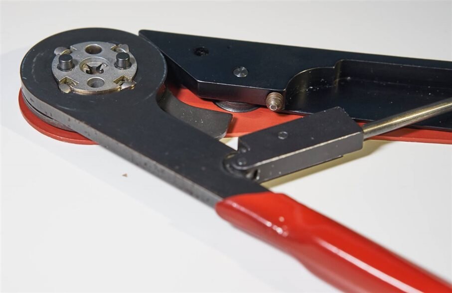

A popular set of tools for crimping pins for some of these connectors is available from Daniels Manufacturing Company (DMC). Typical examples are the AF8 AF8 and AFM8AFM8. They look like very useful tools – the amount of indentation can be adjusted for suiting different diameter pins, and the position on the pin (i.e. how far up or down on the pin) can be selected by using a ‘positioner’ – these are available for different pins, or an adjustable positioner can be attached.
The photo below (from the DMC website) shows a couple of the tools, and how they are used; a positioner is fitted, and then a pin is inserted from the other side of the tool, and then a wire is fed in and then the handles of the tool are pressed together.
(Image source: DMC website)image

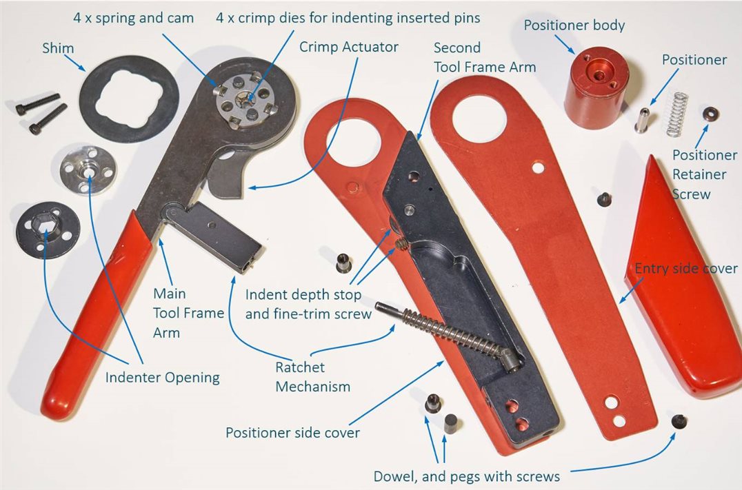

Exploded View
The photo here shows the tool mostly entirely disassembled. I’ve tried to name each part, so that it can be more easily discussed in text. Everything can be disassembled using a couple of hex keys, of size 1/16” and 3/32”. The main tool frame arm and a few other bits are made from steel, and the rest is mostly aluminium, it’s a very lightweight and comfortable tool when assembled!
The tool had seen a lot of use, I cleaned it all up for these photos.

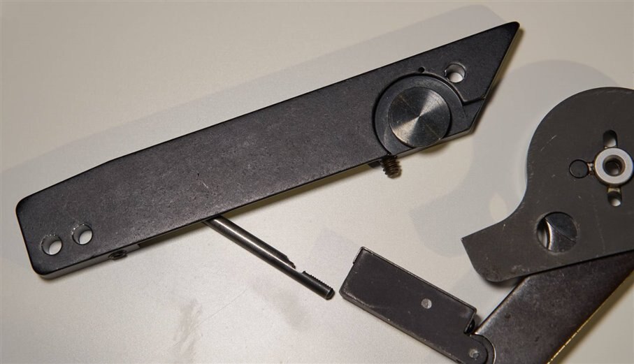

Indent Depth Stop
The photo below shows the ratchet mechanism. More importantly, the photo also shows a circular piece of metal which I’ve called the ‘indent depth stop’, and a screw alongside it for fine-trimming.
The indent depth stop piece and the screw together determine how much of an indent occurs. In order to make a deeper indent into the sides of the pin, then  the circular piece would need to be larger, or the screw would need to unscrewed from the other side slightly.
On the more normal AF8 and similar tools, the indent depth stop is not a fixed circular piece of metal, rather it is a rotatable adjustable piece. That’s a major difference between the normal tools, and the MH800.
The photo below shows the circular indent depth stop piece, and the fine-trim screw, more clearly from the other side.
The photo below shows where a 3/32” hex key can be inserted, to remove the indent depth stop elements just mentioned. They are hidden behind plastic plugs that are easy to pop off.
As you can see in the photo below. the indent depth piece is actually composed of a thick washer located in place using the other piece shown in the photo.
