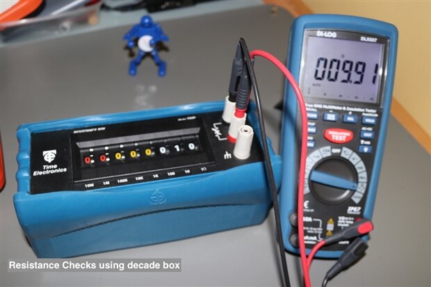

Test set up varied depending on the function, my AC sources can only go u to 300V and my DC source 200V, so I then utilise them to drive high voltage boosters. During this, the voltages are also measured by an 8846A, to provide a direct voltage reading and not rely upon the ratio of the boosters.
Micro and milli amps can be derived direct from my sources, the SMU is accurate enough to do this directly, for the AC I use a burden resistor, driven form the AC source and again cross-reference the readings to the 8846A. The SMU was also used to simulate the temperature readings utilising a conversion table for a K-Type thermocouple, readily available off the internet.
For higher currents above 1A, I can use an SMRT1 injection test set from Megger, that will inject both AC and DC. This has an adjustable frequency output from 0Hz to 1kHz and was also used to test the frequency response of the AC voltage and current functions.
Resistance and capacitance functions were mostly checked via the decade boxes, these values were also verified using the 8846A.

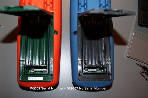

A minor gripe, but I feel it is typical of the quality between the two units, is that the MG302 is supplied with Energiser brand batteries, but the DL9307 came with GoldenPower brand, that have already started to show a voltage drop.
I did note that that the MG302, came with a serial number. I could not find a serial number on the DL9307, quite a surprise for an instrument aimed at professional use that these days requires traceable calibration proof, that almost mandates the use of a serial number on the instrument.
