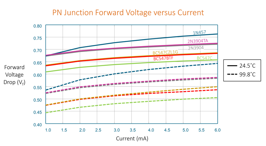

To measure VF, a constant current is passed through the junction, and the voltage is measured across it. For the test, current values of 1,2,3,4,5,6 mA were used.
I decided to test at room temperature, and at close to 100 degrees C, and then use these values to work out the VF gradient over the temperature range, which would be the temperature coefficient. The reason to select these temperatures is because I could achieve them with stability for long enough to take measurements. I'm not an expert in this, as I understand the experts would use scenarios involving glycol and refrigerators.

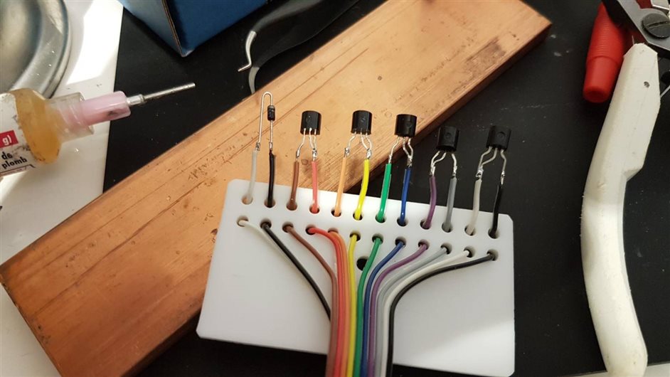

I initially picked a 1N457 diode, because a Texas Instruments LM334 PDF document happened to mention its temperature coefficient was -2.5mV/degC. But I also chose some popular transistors, because a Diode Based Temperature Measurement PDF document, also from TI, suggested that using a BJT was better because it has a more consistent temperature coefficient.
These were the selected devices:
RefPartMnfrFarnell Code
A2N3904Nat Semi
B2N3904TA2N3904TAOn Semi9846743
CBC547BTFBC547BTFOn Semi2453790
DBC547CZL1GBC547CZL1GOn Semi9558578
EBC547CFairchild
F1N4571N457On Semi1467558
It was a deliberate decision to try to pick components from different manufacturers, so see if this made a difference. All parts were from reputable sources (the ones without a Farnell code were either purchased from Farnell or from Future Electronics, but I cannot track those any more, I'd had those for many years). The photo shows the assembled parts from right-to-left, A-F. The base and collector were shorted as the TI document had them in their schematics.

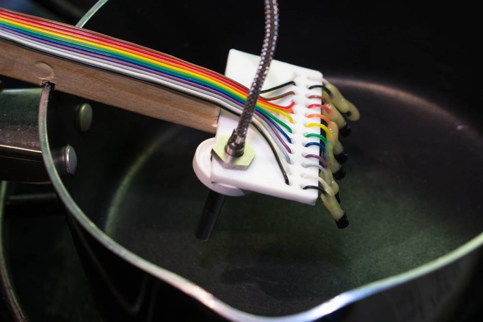

Epoxy glue (Araldite Rapid) was put on the component legs, in an aim to waterproof the joints. After it had set it was repeated for a total of 4 layers, to have confidence that all was sealed. A PT100 probe was also attached to the assembly, just to confirm water temperature. Next, tests were done at room temperature (see further below).

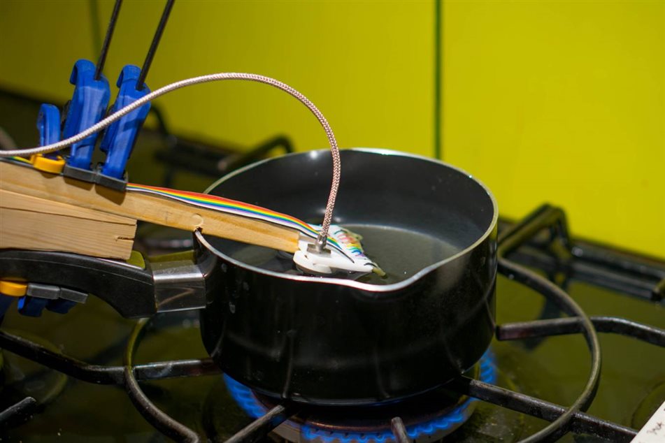

After the room temperature tests, further tests at 100 degrees C were needed. The assembly was attached to a stick and suspended inside a pan/pot. A PT100 temperature probe was also attached.

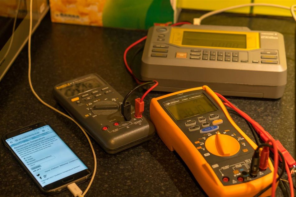

For the current source, a process calibrator was used, since these are portable and easy to move into a kitchen. For the VF measurement and temperature measurement, handheld multimeters were used. The PT100 provides a resistance that varies with temperature, so a normal multimeter set to ohms range can be used, and there are tables (and online calculators) to convert to a temperature reading.
Running the Tests
The procedure was to clip the current source and multimeter set to Volts together in parallel, and then connect to each component in turn, and record the measurement. For the 100 degree C test, the water was boiled, and kept on a medium heat. The PT100 probe confirmed that the temperature was close to 100 degrees C (to within about 0.2 degrees C) throughout the test.

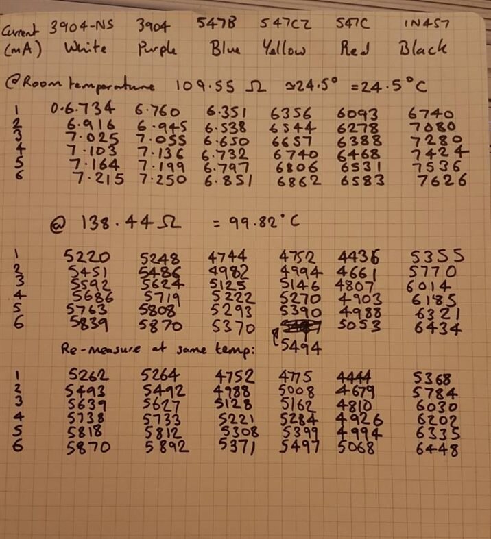

The results that were captured are recorded here:
VF (V)
Current (mA)ABCDEF
temperature:24.5
10.67340.6760.63510.63560.60930.674
20.69160.69450.65380.65440.62780.708
30.70250.70550.6650.66570.63880.728
40.71030.71360.67320.6740.64680.7424
50.71640.71990.67970.68060.65310.7536
60.72150.7250.68510.68620.65830.7626
temperature:99.82
10.5220.52480.47440.47520.44360.5355
20.54510.54860.49820.49940.46610.577
30.55920.56240.51250.51460.48070.6014
40.56860.57190.52220.5270.49030.6185
50.57630.58080.52930.5390.49880.6321
60.58390.5870.5370.54940.50530.6434

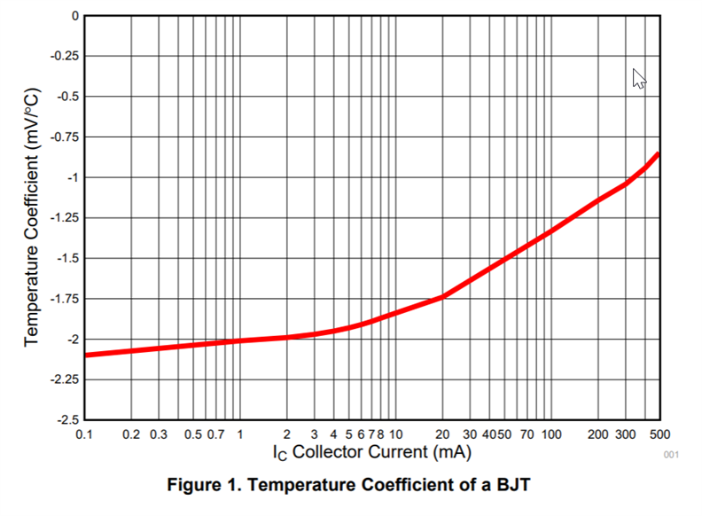

The TI document referred to earlier had this chart for a typical transistor:
It can be seen that the experimental results were similar, they are very close.
The forward voltage versus current was also plotted, just for interest:
As expected, the VF value increased as the current through the p-n junction was increased.
Summary
The results show that for the two BC547 series diodes from On Semi (components C and D) had very similar behavior, especially at the lower currents, whereas the BC547 from Fairchild had a difference.
Surprisingly, the two 2N3904 devices from different manufacturers (Nat Semi and On Semi) had near identical behavior!
Also, it showed that perhaps -2.5mV/deg C is no longer as close an approximation as it could be; maybe -2mV/deg C is a more accurate general approximation.
