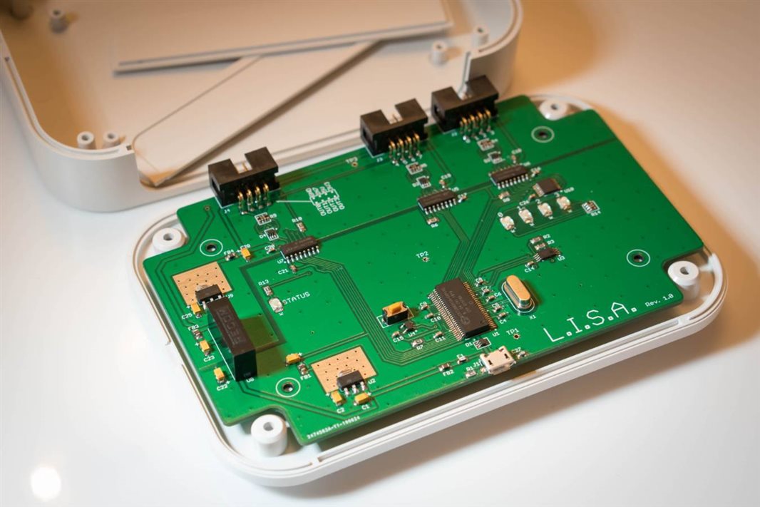

This blog post discusses a project to build a simple logic analyzer (hobby-grade; it samples at up to 24 Msps, good enough for basic debugging when other tools are not available), but it has a few extra features too. This project could be handy for troubleshooting I2C or SPI when working on projects. It can in theory also be used for generating protocol output too, and for operation as a programmer for microcontrollers and FPGAs.
Nearly all digital electronics nowadays has a number of serial busses, either connected between subsystems inside the equipment, or exposed to the outside world. When troubleshooting such electronics, or even when prototyping, occasionally there is a need to attach to these interfaces and either monitor or inject information. These serial interfaces operate at a low-level, i.e. operating at the bits and bytes level and below! Enter the Low-Level Interface and Subsystem Analyzer, L.I.S.A.
It has dual-in-line (DIL) headers for attaching to (say) jumper wires or ribbon cables, to the equipment under test. The other end connects to a PC or Pi via USB. The project is designed to fit into an enclosure, but I have not got around to doing that yet.
Cypress FX2LP
Due to short time to design this project (schematic and PCB layout were completed in one day), I used Cypress Semiconductor’s FX2LP technology because it simplifies high-speed data transfer via USB. FX2LP chips contain a very basic microcontroller, but includes a USB accelerator function that bypasses the processor and allows for data to be shuttled between input/output pins on the chip, and the USB attached host, extremely rapidly. The FX2LP chips work at USB 2.0 High Speed (480Mbit/sec) rates.
(Image source: Cypress website)image
There are also FX3 chips which operate at an incredible 5Gbit/sec (USB 3.0), and I’d like to explore them one day.
Such a design requires the actual protocol decoding to be done on the connected computer. I liked the idea of having some basic, general-purpose hardware that could be attached to any PC, and have the bulk of the processing done on the PC. It should also work with a Pi, for portable, battery-powered use and possibly long-term logging too.
Incidentally, the commercial Saleae logic analyzer uses the same FX2LP chip (I do not own this device, but there are photos of the internals on the web). The Saleae device contains the FX2LP chip and little else. Anyway, it is likely compatible, if the firmware is available. I’m personally more interested in creating new firmware eventually, with the extra features mentioned above. Today, with no firmware or software written for it, it is nevertheless supported by the open source Sigrok/PulseView project, with no extra work, because many logic analyzers use the same chip.
Design Overview
The diagram below shows the functionality on the board. It contains a total of 8 input ports, and 4 output ports. LISA version 1.0 supports 3.3V logic levels only, although it will tolerate 5V on the inputs. Isolated 5V and 3.3V supplies are exposed on a connector, so that LISA can power up some externally attached equipment if necessary.
Everything on the board is hand-solderable with an iron (no need for reflow tools), so this should be an easy project to construct with the minimum of tools.
The project is expandable too; instead of using right-angle header pins, it is possible to use vertical pins, and plug on a board on top, which could (say) expose input/output at different logic levels such as RS232.

Building It
The PCB files are attached to this blog post, ready to be sent to a PCB factory. It is a 2-layer board, 142x90mm. Everything can be hand-soldered with a small-tipped (around 1mm) soldering iron.
A few of the parts need some thought due to the size of them. For the micro USB connector, I put a small dab of solder paste on the pads, and then placed the connector on the board, and then heated the pins. It’s quite easy. I used solder paste in a similar way for the LEDs. Everything else was soldered as usual with thin (0.274mm) solder wire.
The diagrams here can be used for locating the components on the board.
