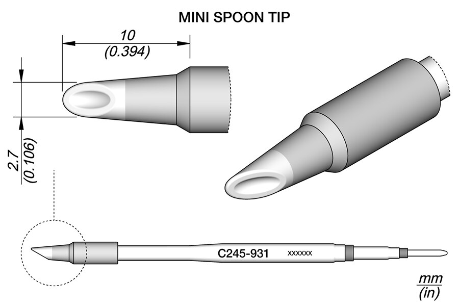

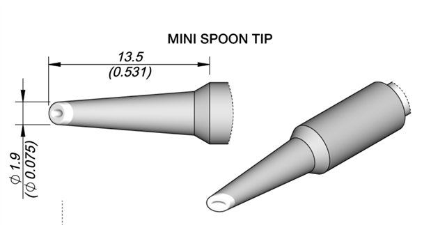

Although I have seen an expert present drag soldering once, I have never tried it because I've been ok with the way I do it - it works, although it is a bit tedious. However, there has been a drag-soldering tip (also known as a spoon tip or gull-wing tip) in my drawer for years, of size 1.9mm diameter. I figured I'd give it a shot since I was soldering a relatively cheap component, and with the recent activity on element14 concerning soldering tools Cool Tools Kit Awards 2020  and soldering station reviews Weller Soldering Station WT Series I figured I'd post a photo of the results..

    I reckon that the key to re-touching surface mount parts is to use lots and lots of really runny flux. I use the Warton metals Future 315 from Rapid Electronics, and it's just like water in terms of viscosity…
    shabaz over 5 years ago in reply to mp2100
    Hi Allen,
    Sorry I should have placed that information, yes that's the type. The one I'm using is a JBC iron tip too, but smaller, part code C245-965 :
    Incidentally I could not initially distinguish this tip visually from other conventional tips, because it comes with solder already in the spoon so-to-speak, they are pre-bulged with it slightly.
  • mp2100
    mp2100 over 5 years ago
    Good to know. . . But I’m not familiar with gull wing / spoon tip. Is it this?  Interesting soldering tip.  (Nice Tip.)  image
