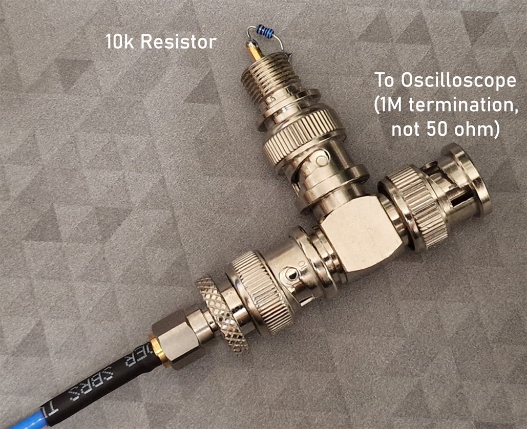

The output can be connected directly to an oscilloscope using a SMA-to-BNC cable. The ‘scope should be set to 50-ohm input termination, and if the ‘scope does not support that, then that’s no problem at all; a BNC T-piece can be used at the ‘scope end, with a 50-ohm BNC terminator twisted on.

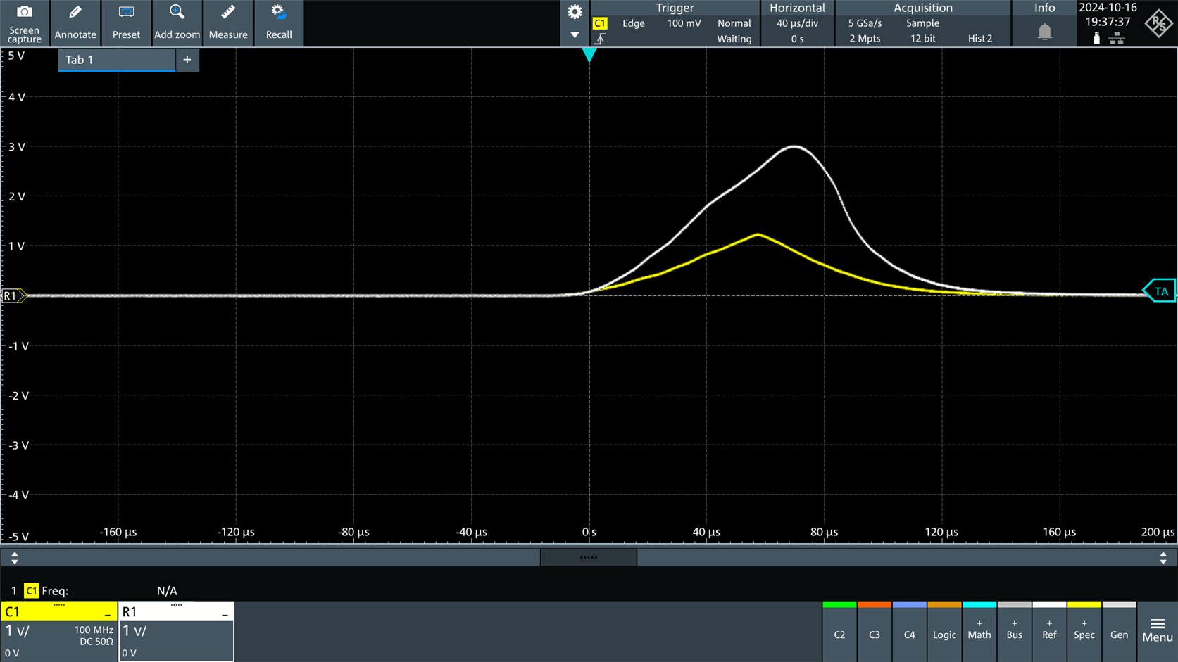

I shone my camera light toward the sensor, and observed that the light has ripple at about 20 kHz. From the ‘scope trace below you can see that the light energy doesn’t reduce to zero; I’m guessing the phosphor covering each LED continues to glow in-between each pulse.

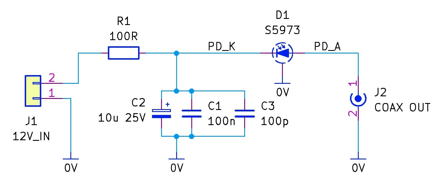

In the comments below, someone asked for nanosecond-level response capability. There's a S5973 diode from Hamamatsu, which is suitable for that! It uses a different PCB:
The main difference is now some more care is needed with the capacitor placement (and a 0402 capacitor is also required), and a short (100mm) U.FL to SMA cable is used to attach the output from the front PCB to the rear PCB.
This is the circuit diagram:

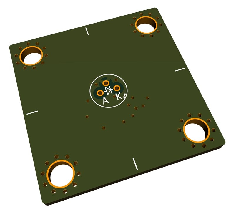

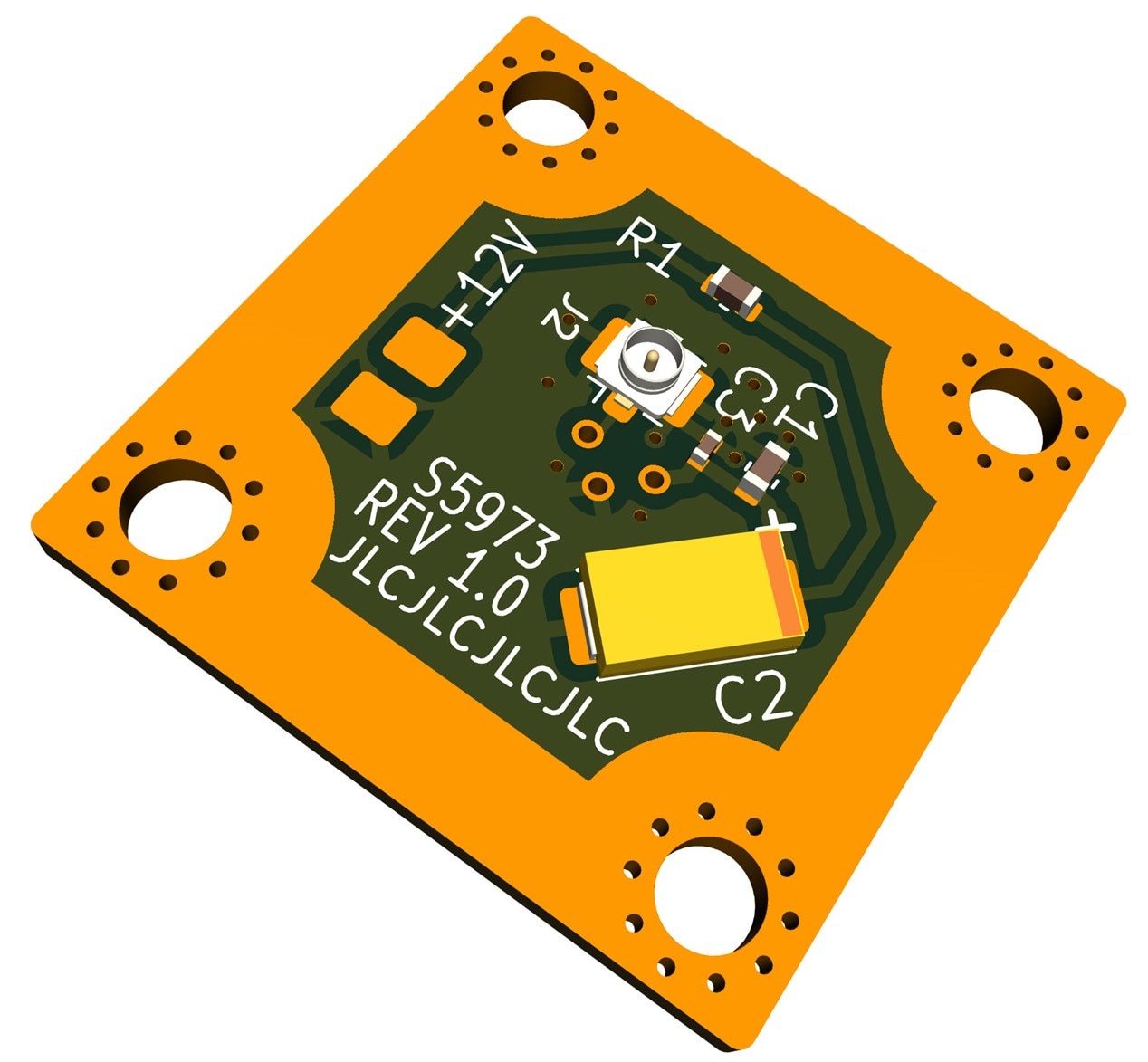

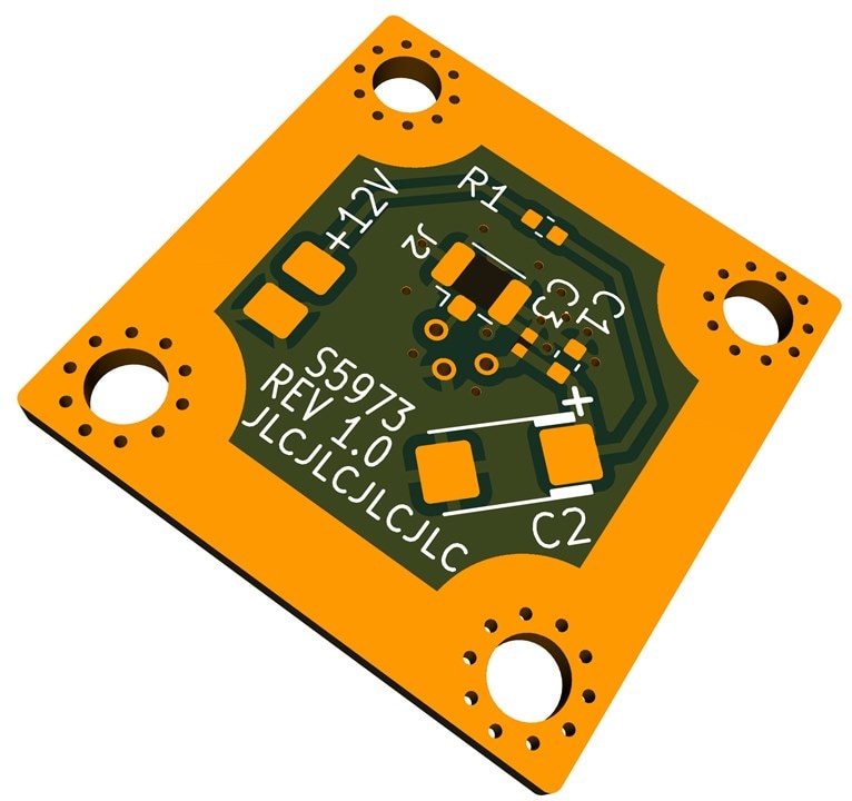

    shabaz over 1 year ago in reply to JApetWophy
    Hi,
    I've made the changes, and the file is called export-gerbers-s5973-rev1.zip available at the project GitHub repo. You'll need that plus the export-gerber-pd-sma-rev1.zip file, which is the rear panel.
    This is what the s5973 board looks like top-side, where the S5973 photodiode will fit.
    Board underside:
    With the parts fitted:
    The circuit is shown below, it has an extra capacitor (0402 sized), and uses a U.FL connector (both of these are required now that such a higher speed photodiode is being used), the connector will attach to a short 100mm length U.FL to SMA cable, and from there you can use any SMA-to-BNC cable to connect to an oscilloscope (which needs to be set to 50 ohm input impedance as mentioned in the blog post, otherwise, you'll need a BNC T-adapter and a good quality 50 ohm terminator (which mostly doesn't exist in good quality in BNC form, so then you'd need to buy a SMA BNC terminator and a SMA-to-BNC adapter).
