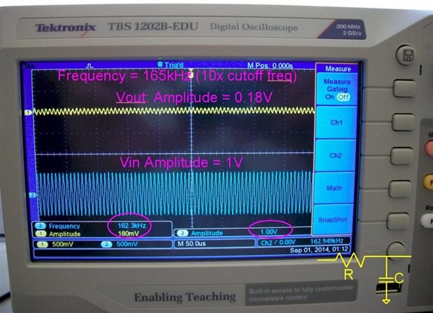

Next let’s increase even more the frequency.  The following figure shows what happens at 165kHz, which is about ten times the cutoff frequency.
Notice that the amplitude at the output has been reduced to 0.18V.
So as we increase the frequency the low-pass RC filter attenuates the amplitude of the output signal, towards the zero value.
