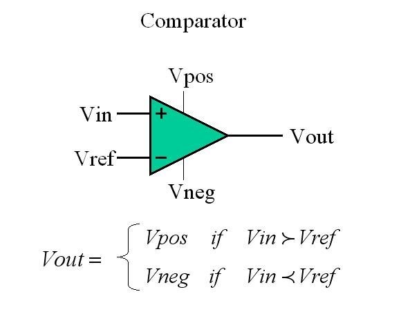

Operational Amplifier Used As Comparator
When configured in open-loop mode, an operational amplifier functions as a comparator.  The figure below shows an operational amplifier used as comparator.
When the voltage on the “+“ input is higher than the voltage on the “-“ input the output will increase all the way to the positive voltage supply level. When the voltage on the “+“ input is lower than the voltage on the “-“ input the output will decrease all the way to the negative voltage supply level.  To illustrate this functionality I have built the experiment shown in the figure below.
Channel 1 (yellow trace) probes the input, which is a triangular signal, and channel 2 (blue trace) probes the output.  As the triangular signal goes above the Vref reference level, the output raises quickly to the positive supply level and remains there as long as the input is higher than the reference.  Then, when the input triangular signal decreases below the reference voltage, the output drops down to the negative supply level.
