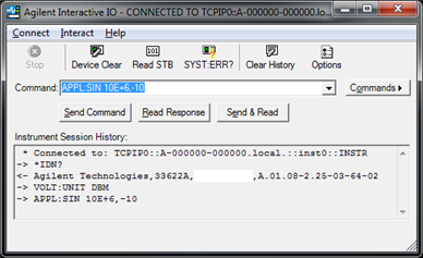

     Now that we have a working connection to the counter, all that's left to do is figure out if the commands we're planning to send will actually work. The simplest way of testing this is to bring up the Interactive IO dialog for both instruments and send SCPI commands.
     You may notice that in this case I used APPLy instead of issuing a separate command for each particular subsystem. For our little experiment, addressing each subsystem individually would make more sense, but I figured I'd show off this SCPI command, because I find it more useful/convenient than the other ones. After this test, we know that we are going to use the following commands:
VOLT:UNIT DBM          // Set the Waveform Generator to use dBm instead of V for amplitude
APPL:SIN 10E+6, -10    // Set the shape of the signal, the frequency and the amplitude in dBm
READ:FREQ?             // Get a frequency reading from the frequency counter
     In order to keep the code as simple as possible, I didn't bother with enabling the output of the waveform generator, setting the input load via SCPI or even finding the devices like we did with the previous programs. Enabling the output and setting the input load can be done manually before running the test, while the instrument descriptors can be found in the Agilent IO Control and then hardcoded into the program.
