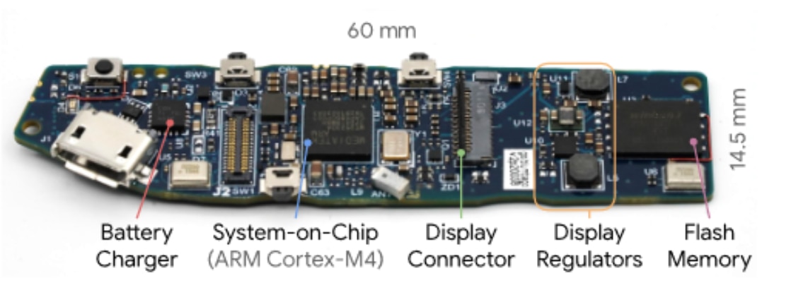

The researchers say that these smart glasses, which use a low-power microcontroller architecture, can function for 15 hours a day before needing to be recharged. This prototype contains a very thin PCB with MediaTek MT2523D System-in-Package (SiP), which is a single chip Cortex M4F with Bluetooth 4.0 EDR and Bluetooth Low Energy (BLE) transceiver. It also consists of power management, MIPI-DSI display controller and memory subsystem. All of this is packaged onto the right temple of the 3D-printed frame, where it’s neatly hidden out of sight from others. The system communicates with the smartphone via BLE and utilizes the phone’s microphone and a communication protocol to write out the words and sounds.
The 8-layer PCB assembly contains wireless communication and display. (Image Credit: Google Research)
The team implemented the application layer using Protocol Buffers with message types for drawing graphics primitives, configuring sensors and peripherals, and changing device modes. There is another set of message types responsible for transmitting sensor data, compressed audio captured from the system’s microphones, and remote procedure call (RPC) send values back to the phone.
