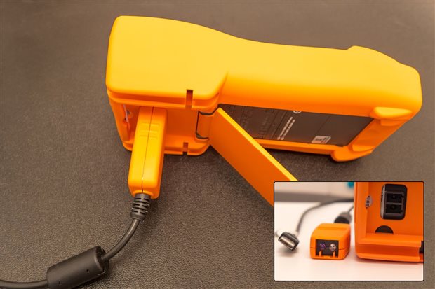

The multimeter looks like a COM port to the PC and as a SCPI device to the software through VISA drivers. In brief, once the IR-USB connector has been clipped on the multimeter can be controlled and monitored via the PC just like any other test instrument.

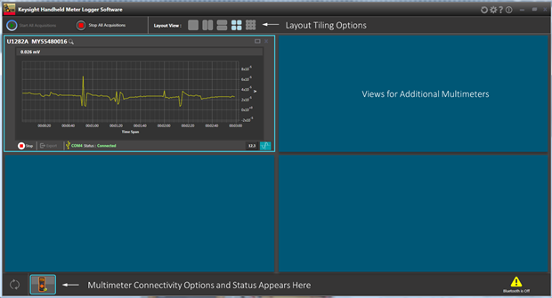

The Handheld Meter Logger Software was downloaded from the Keysight website and it was straightforward to use. The left side area is used to configure up when to capture data. The remainder of the area can show graphs, a huge live display of the multimeter LCD or show tables of data. If you have multiple multimeters then they can all share the same software; the display can be split horizontally, vertically or into grid tiles for up to 9 multimeters.
The graphing functionality is no replacement for a true math program but it does allow you to insert time cursors and examine the min, max and average over the period. The data can be exported to Excel (not advisable with massive data sets) or MATLAB or your choice of software; it can be exported in CSV format.
The software looks a bit version 1.1 (but it is version 3.1!) in that although the functionality described works and nothing fatal was experienced, some things could be further improved for a bit more usability or without workarounds. There are nevertheless some very interesting capabilities which I briefly tried.

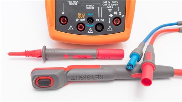

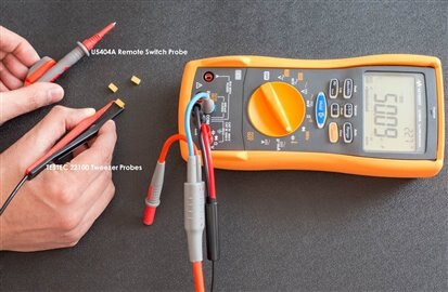

One feature that I am going to be using a lot of is the ability to log individual readings with a press of a button on a probe. This is exceedingly powerful. One use could be to measure voltages on multiple test points on a board. It would be possible to rapidly collect all measurements together. An audible beep tells you that the measurement has been collected. Data points can be deleted if needed.

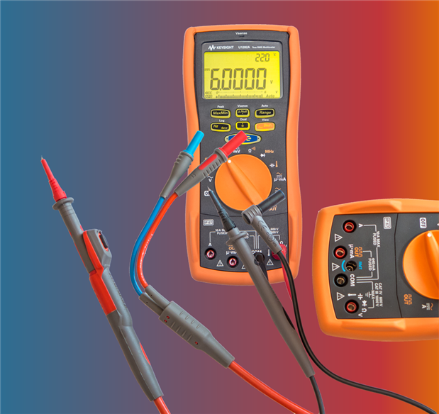

The Remote Switch Probe (U5404A) is essentially just a probe (it can replace one of the two probes connected to the multimeter) with a button brought out to the finger grip area. It is a simple thing but means that eyes and both hands can be focussed on the circuit or device under test. Once the operator is ready to capture a measurement the button on the finger grip area is depressed and start and stop beep notify when the signal has been stable for a sufficient amount of time (a fraction of a second) to capture a value reliably. Helpfully the measurement range and the timestamp is captured and recorded too. Then you can move on to the next measurement, at no point losing focus from the testbed. The rubber button is squidgy and is like the ones on TV remote controls, but it is clear when the button has been successfully pressed through the audible beep. Without the beep I’m not sure I could trust the button.
The Remote Switch Probe button is brought out to a circular blue connector and it mimics the function of a button on the body of the multimeter.
Another use-case would be to quickly go through a batch of components to perform some manual binning. I tried it with LED forward voltage measurements for a batch of ten. Technically the remote switch probe can also be used just as a remote switch if you only plug in the blue connector, and you can then plug in your own test probes, for example tweezer probes which can be used single handed.

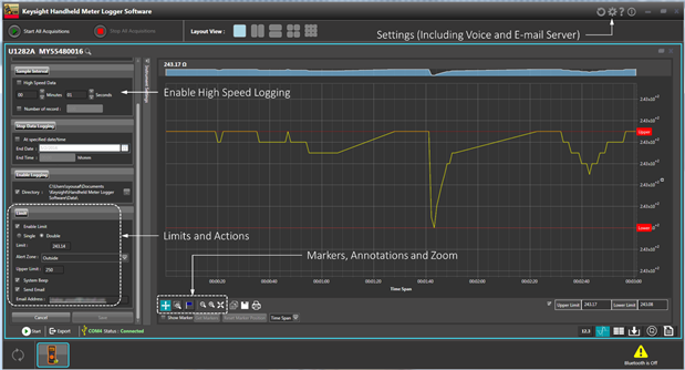

It is possible to set up a few different types of limits (for example upper and lower) and upon occurrence the PC will beep, and can also send you an e-mail. This functionality worked well but the boxes for the thresholds did not seem to handle exponents (E characters) which are useful when dealing with extremely small or large values.
Voice Alerts
A voice feature allows the software to repeatedly speak the current measured value through the PC speaker. It could be useful when your eyes need to focus on the probes and not the display.

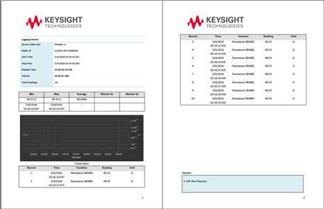

Report Generation
There are a variety of reports templates including tables of data and a graph and even a histogram capability, and it will export to Word or PDF format.

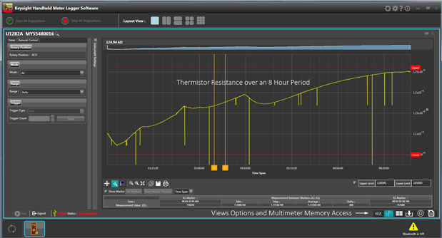

The High Speed feature was claimed to support up to 10Hz update rate, and it does support that across all the measurement types including voltage, current, resistance and capacitance and all the ranges for them. The captured data at this high speed is very clean; there is the occasional misreading but this can be filtered out. In a more than 8 hour period, about 18 resistance measurements were misreadings out of 300,000 data points. (It was subsequently found out that the misreading was due to being in auto-range, where the meter needs to do a refresh occasionally and that involves it changing the meter setting. The solution is to place it in a manual range prior to starting the data logging, and then there are no such misreadings. Note: Keysight are considering forcing the range to be manual for the logger software as a possible future enhancement). The resistance of a thermistor placed in a room was measured over an 8 hour period and the graph of the results is shown in the image below.

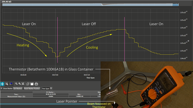

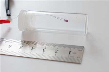

The granularity and precision allows for some interesting experiments that I never thought possible with a multimeter. It would be perfect in a science classroom along with the software displayed using a projector.
By placing a thermistor inside a glass jar to isolate it from temperature fluctuations (e.g. due to convection currents) in the room and then using a laser pointer to heat the thermistor, sub-mW power levels can be easily observed.
The Kensington laser pointer was a Class 2 device Probably a few tens of uW is observable with the U1282A connected to a thermistor.

As mentioned there is memory for 10,000 data points on an interval basis built-in to the multimeter. With the extremely long reported battery life for the U1282A (800 hours) it would be possible to capture data for days or perhaps weeks. The battery life was impacted by just a few percent during eight hours of logging to the PC.
