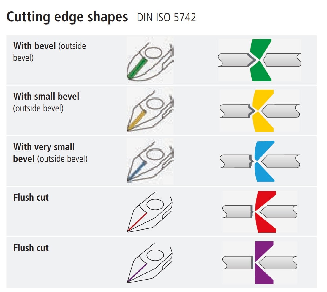

Ever wanted to know what all those funny symbols meant on the Knipex website? At least for me, it was not straightforward to locate the info.
It turns out that the symbols are described in their catalog pages near the end. I will paste them here for convenience (and I will delete them if anyone has an issue with that).
Image source: Knipex website, product catalog.
The weird symbol that looks like a sideways eye, indicates that there is a wire-catcher for preventing the cut ends pinging across the room.
The zigzag symbol indicates that the cutters spring open, which most of the ones intended for electronics do, as far as I can tell.
Fairly key for wirecutters are the colored symbols which indicate the amount of flushness of the cut. Purple is completely flush and square. I think blue could be a nice compromise.
