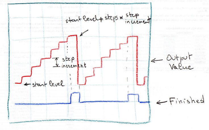

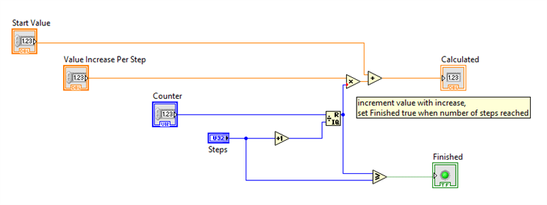

It's a small calculation block that allows you to increment a setting of an instrument a given number of times, with a given step size.
It starts from a given start value.
When it reaches that maximum, it starts counting all over from the start value.
It's Counter input is typically a loop counter.
When it reaches the upper limit, it sets a Finished flag. You can use that value in your downstream flow to stop looping.

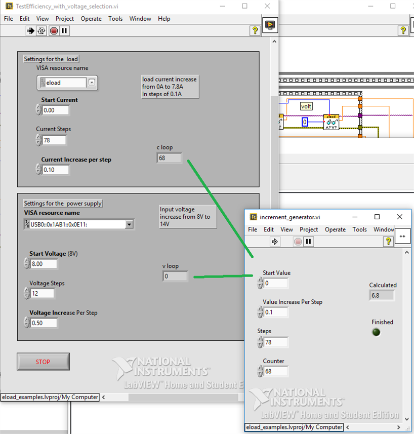

In the example below, I use this block two times.
One time in the lower section (outer loop) to make a power supply loop between 8 V and 14V. Without exit. This one keeps looping forever.
The other timer in the top section (inner loop) makes a DC load loop between 0 A and 7.8 A. With exit. Once the upper limit is reached the loop breaks and returns to the outer loop.

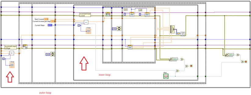

Here's the block diagram of the outer and inner loop of that process. The two Increment Generators are highlighted.
You can see that in the outer block the Finished flag isn't used. This loop keeps running until an operator presses the Stop button.
In the inner loop, the Finished flag is used to end the loop's execution and exit back to the surrounding block.

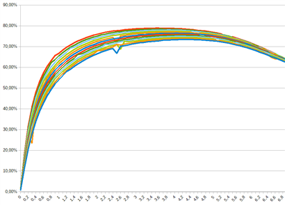

The example above is part of an efficiency logger for a dc to dc converter.

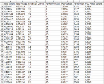

Here's output data, and a graph based on such measurements.
Each line in the diagram above represents 1028 test setups. From 0 V - 0 A to 14 V -7.8 A.
On each step you need to measure the power at input and the power delivered by the device under test, to measure efficiency.
