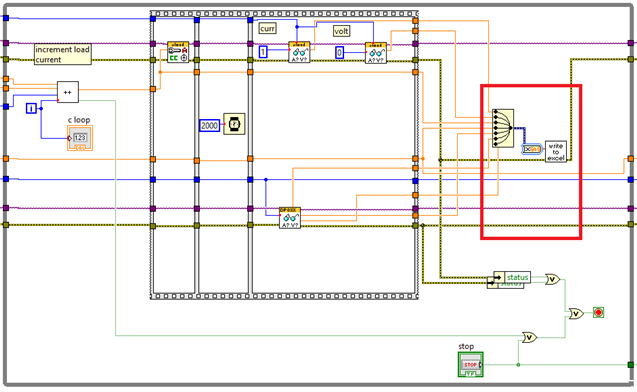

This blog is born out of need. My "write to Excel" blocks were taking way too much real estate of my Labview main flow. This blog explains how I

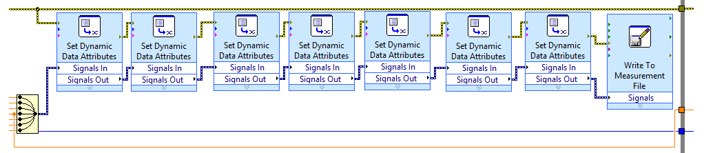

LabVIEW has a Set Dynamic Data Attributes block that allows you to tell what (among other things) the column name for a signal is.

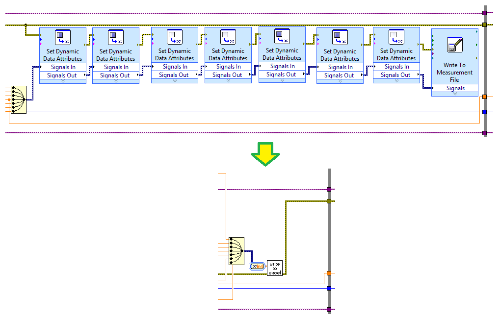

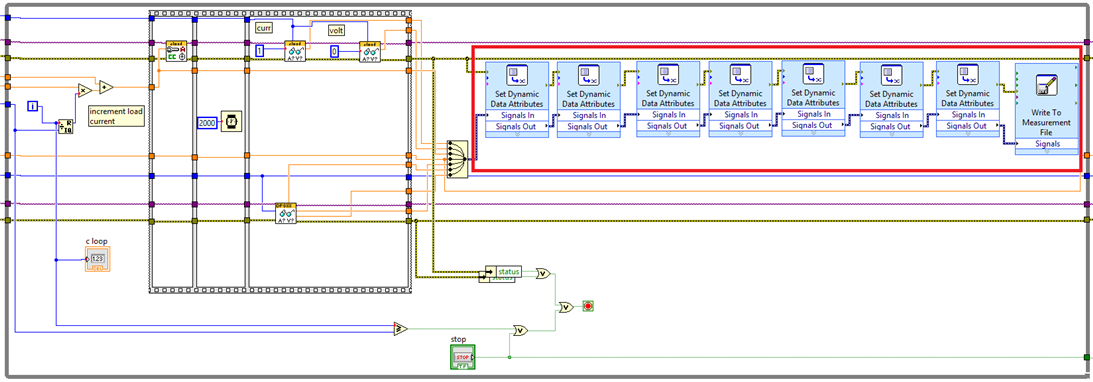

You'll need a block for each of your signals. In my case I'm sending seven signals, so my flow will have seven blocks on the flow diagram.
And these seven blocks take significant horizontal space of the workflow, without giving the user much insight of what's happening.
I prefer to only show in the main flow what's necessary to understand what's going on and why a process is branching left or right.
For the reader, it is enough to see that the data is logged to a spreadsheet. The Set Dynamic Data Attributes blocks don't add any visual insight.
I wanted to move the details of the data logging to a separate block, so that the main flow only showed a Write To Excel block. That's enough info for the main flow.

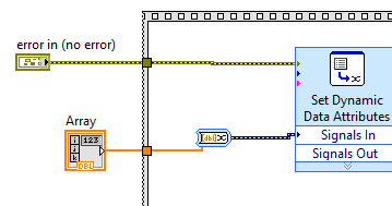

On the submodule, define an array. That will be your input parameter. Drop a numeric control on it so that it becomes a numeric array.
Then link that block with the first Set Dynamic Data Attributes block.
This will automatically insert a Convert to Dynamic Data block.

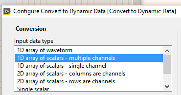

But then there's something you have to change: right-click on that converter, and select properties.
Then select 1D array of scalars - multiple channels.
That's it. On the Front Panel, link the array with an input parameter.
You can now link your merged signals with your submodule:
LabVIEW will again automatically insert a block: Convert from Dynamic Data. You don't need to change that block.
That's it actually. You can now link your merged signals to your submodule.
Before:
After:
